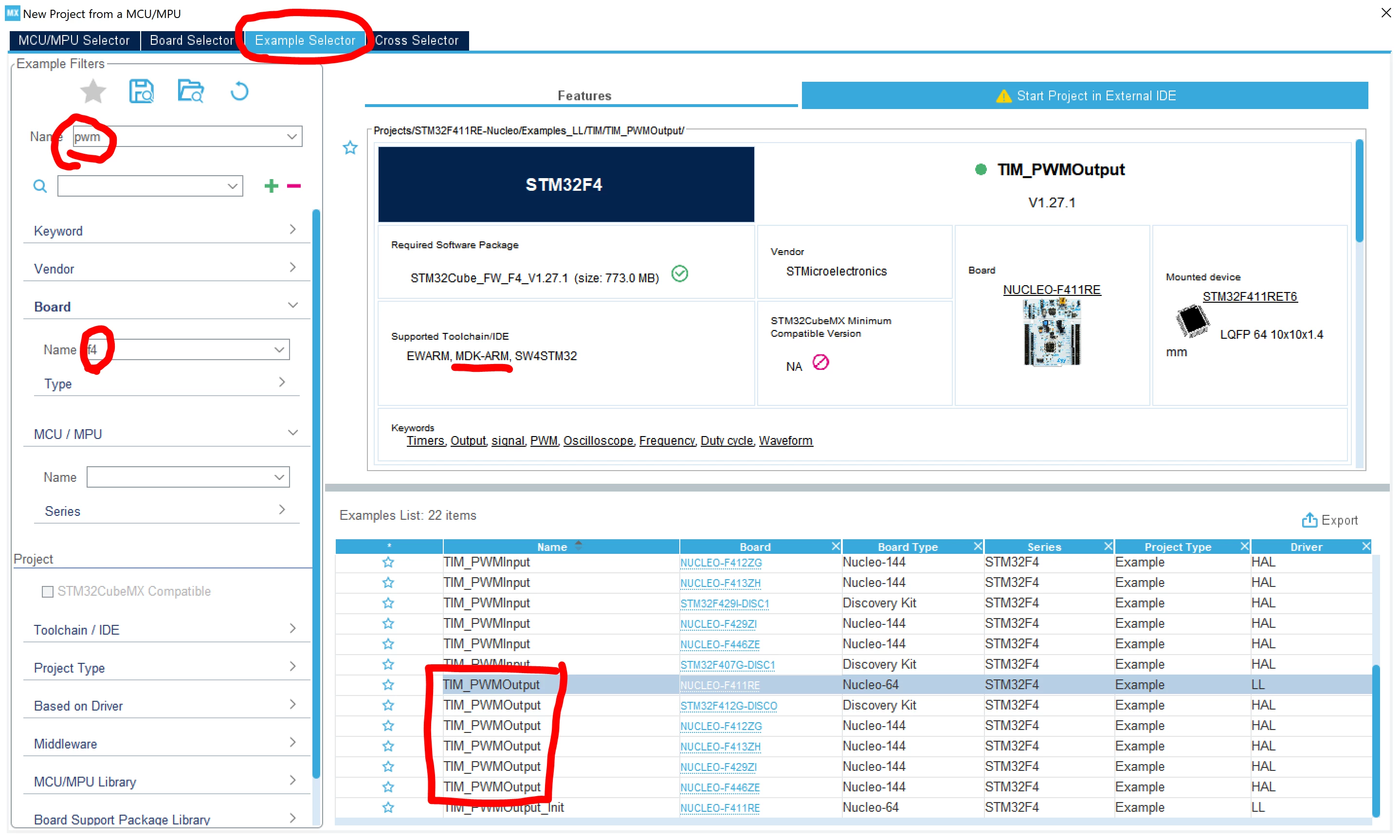

Oct 25, 2023 1:46 PM UTC
Use the Example Selector in CubeMX to generate a PWM example project.

Nov 7, 2023 2:13 PM UTC
If you can't use CubeMX tool for code configuration/generation, you can also refer and inspire from the example provided in STM32CubeF4 under the path STM324xG_EVAL\Examples\TIM\TIM_PWMOutput
