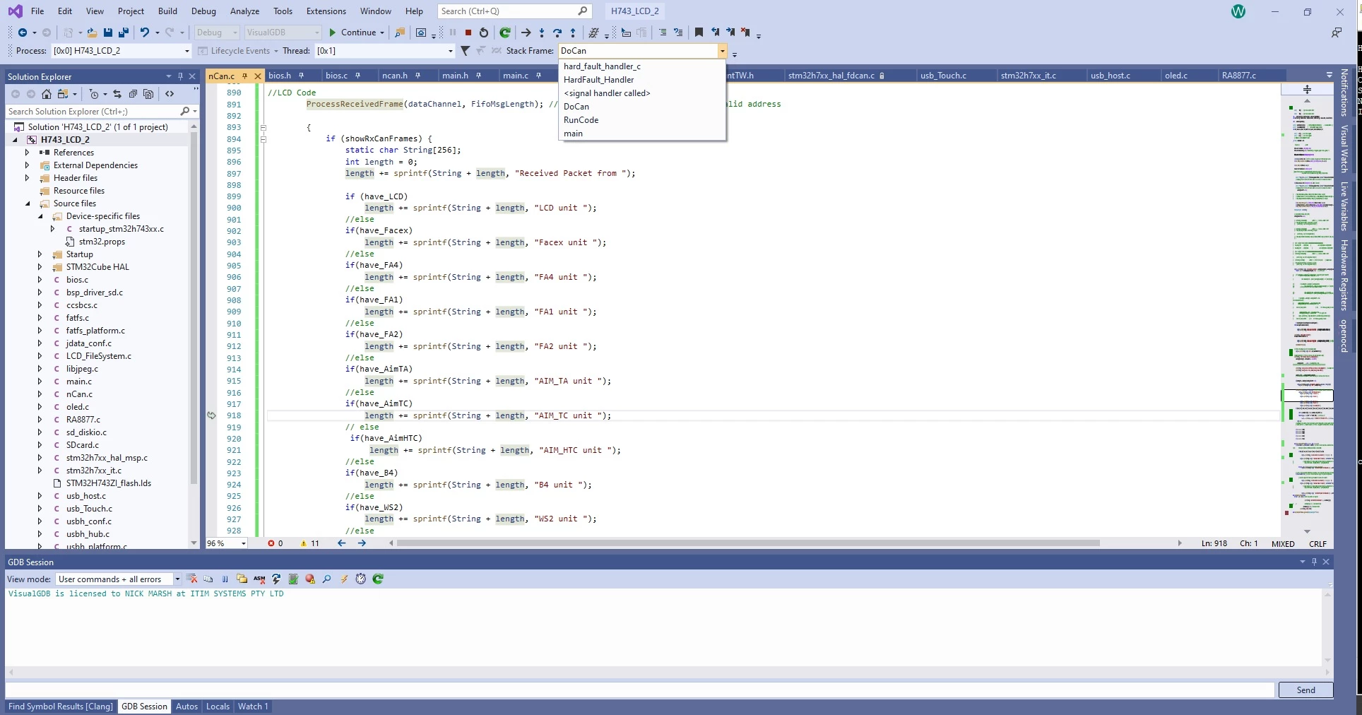

    Trevor Jones
    Senior
    January 16, 2020
    still fails with ICache OFF,
    here is the errant code:
    	 ProcessReceivedFrame(dataChannel, FifoMsgLength); // check if this packet contains a valid address
    		 if (showRxCanFrames) {
    			 char String[256];
    			 int length = 0;
    			 length += sprintf(String + length, "Received Packet from "); // this line works
    			 if (have_LCD)
    				 length += sprintf(String + length, "LCD unit ");
    			 //else
    			 if(have_Facex)
    					length += sprintf(String + length, "Facex unit ");
    			 //else
    			 if(have_FA4)
    					length += sprintf(String + length, "FA4 unit ");
    			 //else
    			 if(have_FA1)
    					length += sprintf(String + length, "FA1 unit ");
    			 //else
    			 if(have_FA2)
    					length += sprintf(String + length, "FA2 unit ");
    			 //else
    			 if(have_AimTA)
    					length += sprintf(String + length, "AIM_TA unit ");
    			 //else
    			 if(have_AimTC)
    					length += sprintf(String + length, "AIM_TC unit "); // <- fails here
    			 // else
    			 if(have_AimHTC)

    Can you change behaviour with a "static char String[256]" ?
    Doesn't look bad..
    Does length look problematic? Clearly don't have 256 chars in preceding sprintf
    Trevor Jones
    Senior
    January 16, 2020
    nope, same result,
    attached.... with code stack shown
    indicator of failed point...
