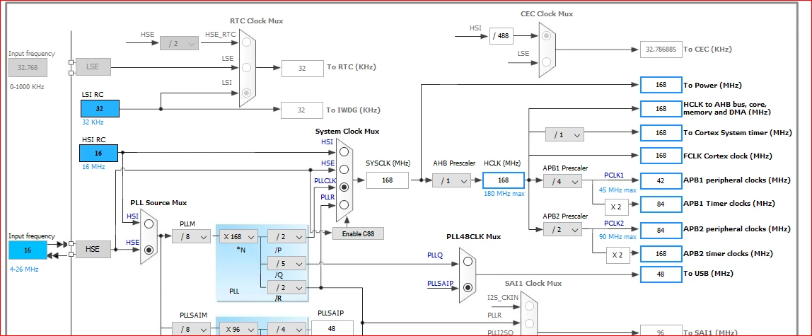

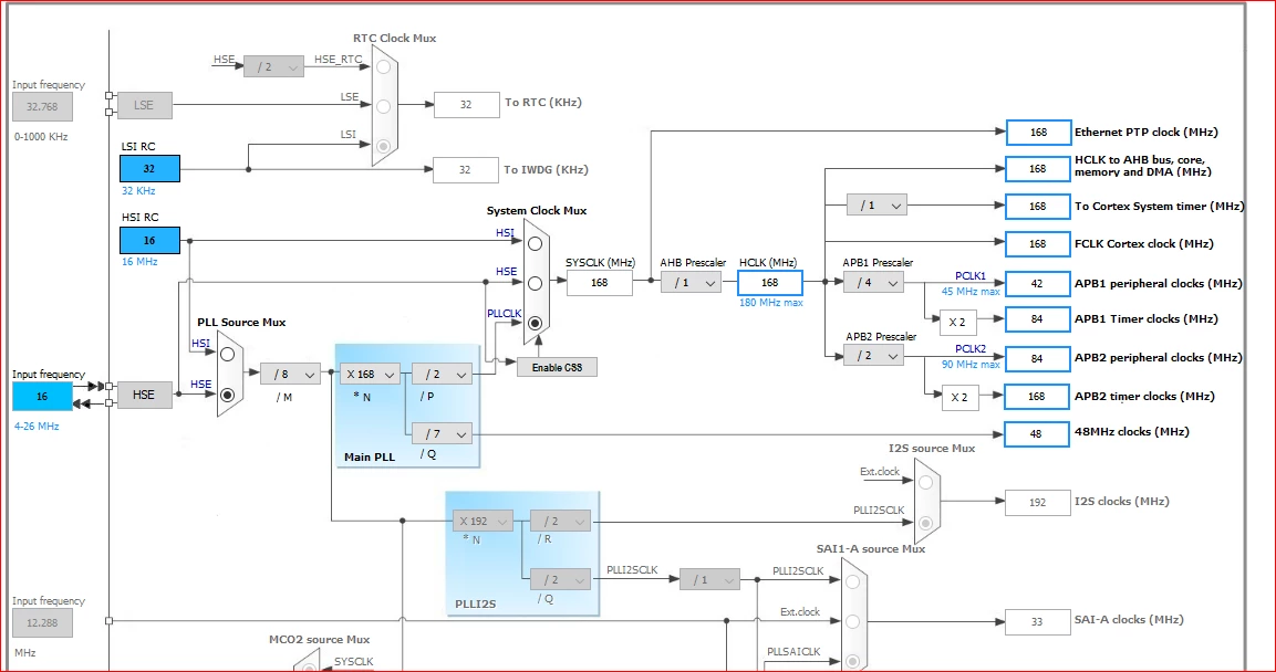

Hello everybody,
i want to use Spread Spectrum on the STM32F429BIT but i want to use USB too.
Is there a possibility to run the USB on a clock without Spread Spectrum?
For example the STM32F446 has the option to choose between PLLQ or PLLSAIP.
Clock of STMF429
Clock of STMF446
