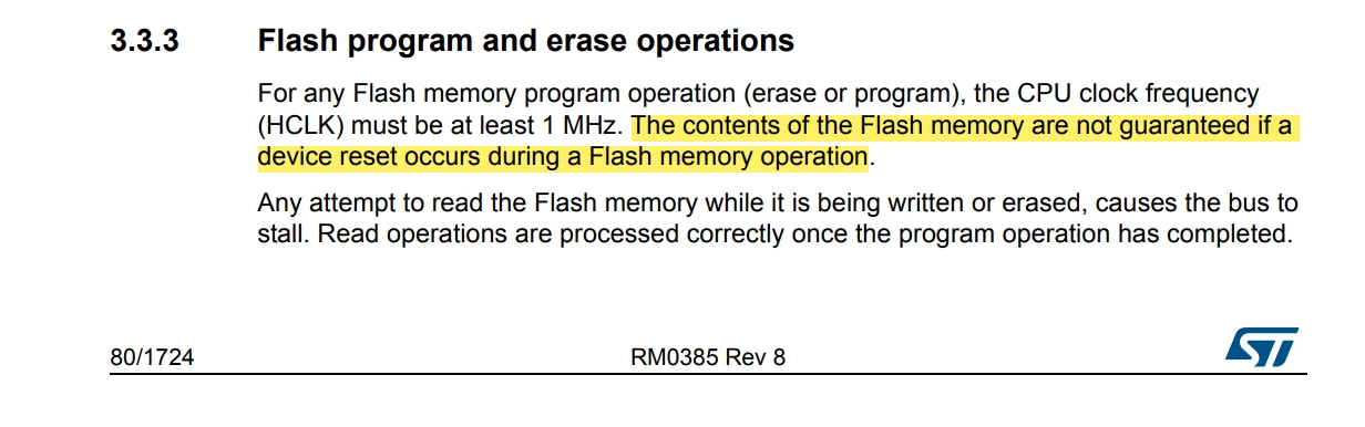

Spontaneous setting of RDP 1 after reset when saving option bytes
Board: Nucleo-f756ZG and Nucleo-F767ZI
When i reset quickly board using reset button during execute below code, The board set RDP protection Level 1.
Below code contains only rootcause. I know that is not correct usage (missing OB lock, wait for busy flag etc) but i have an application that using
FLASH->OPTCR |= FLASH_OPTCR_OPTSTRT
 and after quick
reset
 few times, the application freezed (like after changed RDP). I checked the board using STM32CubeProgrammer and the board have set RDP level 1 after this case.
Larger gaps (above 1 second) between resets do not cause this problem.
My code:

Dear @Kamil Duljas​ ,
Writing to Options bytes is an operation of Erase/Program to embedded flash memory and should be done properly and safely, having a system reset or power down during that operation phase may lead to improper programming in the non-volatile memory and in this case the RDP byte is set to an unknowing data and so RDP1 is activated. this is a normal behavior . Hope it helps you.

@STOne-32​ But this is not deliberate? Say, as a counter-measure against assumed hardware attack to read-out the firmware?

Dear @kamil Duljas​
Here it is in STM32F7 Reference Manual
_legacyfs_online_stmicro_images_0693W00000dK21WQAS.pngIt would be interesting to read the content of the RDP byte and see its value : 0x00 , 0xFF or any other value in your case. Hope it helps you
