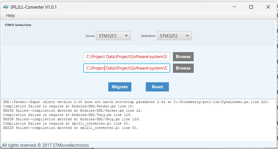

Dear all,
I am trying to convert the SPL to LL using the SPL2LL converter. After pressing the migrate button, I got the message below. Please help. Is it the problem that I chose the wrong directory? I chose the directory where the main.c file is located (./). All the others' ./apps are stored in /app.
I don't know. Try simpler pathing, and perhaps without spaces or special characters.

Dear Tesla and Andrew,
I removed the space, and no special characters were on the path. There are still error messages.
Is it the problem of Strawberry Perl? I installed ActiveState Perl and Strawberry Perl at the same.
After installing the older version of Perl, I can run the SPL2LL converter now.
Thank you so much.

Dear Andrew,
I used the old Perl version. The higher version is not supported.

Andrew Neil
May 14, 2024
I've never used it, so I have no idea.
However, the errors you posted in the OP don't seem to be about failure to find your source files - they look more like errors in the utility itself.
EDIT:
You didn't answer the question of what Perl version you are using.
You should probably also state what platform you're running on, version, etc ...
