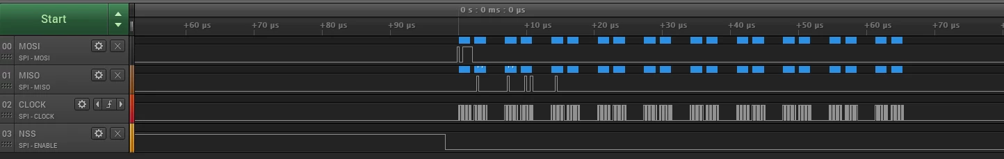

Hello there,
with my STM32F103, I'm working with the M25P40 SPI flash memory.
With cube32Mx I configured the SPI3 with Chip Select (NSS) hardware and I perform Read/Write/WriteRead operation with Interrupt.
My problem regards the NSS, in particular the NSS signal stay low after the read operation end and the:
  • HAL_SPI_RxCpltCallback
  • HAL_SPI_TxRxCpltCallback
are never invoked.
Looking the signal with Saleae Logic Analazer, I saw that NSS signal stay low.
Instead, theHAL_SPI_TxCpltCallback is invoked.

That's how it's supposed to work - read the RM.
If you want framing, you have to do it 'manually'.

RM0008, SPI chapter, Slave select (NSS) pin management subchapter:
The NSS signal is driven low when the master starts the communication and is kept
low until the SPI is disabled.
If you want to set the pin to 0 before communication starts and to 1 after communication ends,  you have to set it as GPIO and write the code to manipulate it.
