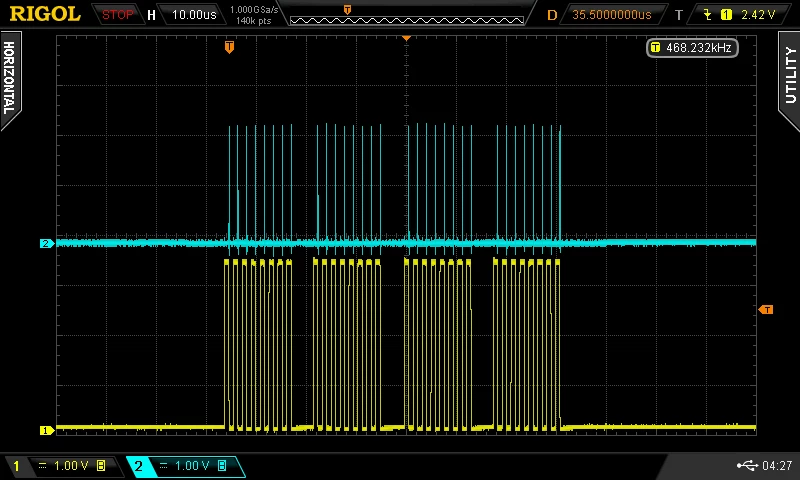

Hello everbody,
Im using a STM32F303 and want to communicate with a MAX31855.
Im using the STM in full duplex master mode, under 1MBit/s data rate and standard settings.
CS ist working fine, SCK is working fine (want to read 4 times 8 bit, 32 pulses), but the connection between MISO at the STM and Data Out (DO) from MAX stays low with 32 little peaks in phase with the clock frequency (see picture: verbundene Leitung).

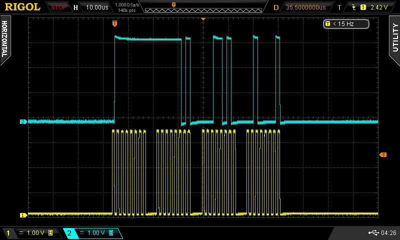

If I disconnect the STM from the MAX31855, I can see the right data on the Oscilloscope (see picture: offene Leitung). No shorts between the pins on the STM, no shorts to vcc or ground.
I have no idea what is going wrong. All SPI Settings are generated with the CUBE IDE.

I don't see a problem. What are you expecting instead? MISO is an input to the STM32 if the SPI is in master mode. If it's not being driven externally (i.e. if the MAX chip isn't there), it's subject to noise and crosstalk. Spikes on clock transitions are how this typically shows up.
AScha.3
Nov 10, 2022 6:18 PM UTC
no, if i understand it : open line show signal...so exchange miso/mosi , you connect now output to output ! (is almost ..Kurzschluss ! )
