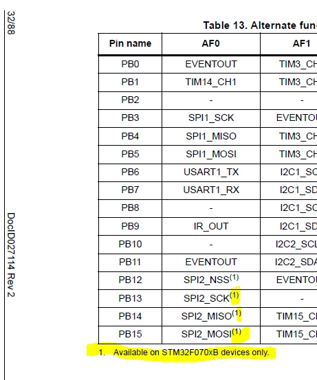

currently i am working in Fatfs with stm32f070 with spi1.
when i move to spi2 its not working.
i am trying multiple times but i cant get success.
here is my init function
void SPIFlashInit(void)
{ SPI_InitTypeDef SPI_Struct; GPIO_InitTypeDef GPIO_Struct; uint32_t stat;RCC_APB1PeriphClockCmd(RCC_APB1Periph_SPI2, ENABLE);
RCC_AHBPeriphClockCmd(RCC_AHBPeriph_GPIOB ,ENABLE);
RCC_AHBPeriphClockCmd(RCC_AHBPeriph_GPIOA ,ENABLE);GPIO_Struct.GPIO_Pin = GPIO_Pin_15;
GPIO_Struct.GPIO_Mode = GPIO_Mode_OUT; GPIO_Struct.GPIO_Speed = GPIO_Speed_50MHz; GPIO_Init(GPIOA, &GPIO_Struct); GPIO_WriteBit(GPIOA,GPIO_Pin_15,Bit_SET);// Configure SPI1 pins: SCK, MISO and MOSI
GPIO_Struct.GPIO_Pin =GPIO_Pin_13
|GPIO_Pin_14
|GPIO_Pin_15
; GPIO_Struct.GPIO_Mode = GPIO_Mode_AF; GPIO_Init(GPIOB, &GPIO_Struct); //Configure I/O for Flash Chip select // GPIO_PinAFConfig(GPIOB,GPIO_PinSource13,GPIO_AF_0); GPIO_PinAFConfig(GPIOB
,GPIO_PinSource14,GPIO_AF_0); GPIO_PinAFConfig(GPIOB
,GPIO_PinSource15,GPIO_AF_0); //SPI1 configuration SPI_Struct.SPI_Direction = SPI_Direction_2Lines_FullDuplex; SPI_Struct.SPI_Mode = SPI_Mode_Master; SPI_Struct.SPI_DataSize = SPI_DataSize_8b; SPI_Struct.SPI_CPOL = SPI_CPOL_Low; SPI_Struct.SPI_CPHA = SPI_CPHA_1Edge; SPI_Struct.SPI_NSS = SPI_NSS_Soft; SPI_Struct.SPI_BaudRatePrescaler = SPI_BaudRatePrescaler_2; SPI_Struct.SPI_FirstBit = SPI_FirstBit_MSB; SPI_Struct.SPI_CRCPolynomial = 7; SPI_Init(SPI2, &SPI_Struct); SPI_RxFIFOThresholdConfig (SPI2,SPI_RxFIFOThreshold_QF); SPI_Cmd(SPI2, ENABLE);}
please ans me where i am wrong in this code.
