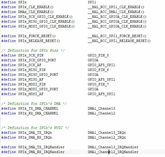

Mike_ST
March 6, 2020
Check the HAL_SPI_MspInit( ) function in stm32f3xx_hal_msp.c and reroute the SPI1 to te right pins if not done.
SPati.3
SPati.3Author
March 6, 2020
SPati.3
SPati.3Author
March 6, 2020
This is the configuration of SPI1 pins used.
