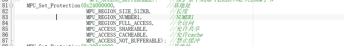

Tesla DeLorean
Guru
September 9, 2019
Make sure you're using the right memory or the right buses. Check bus matrix diagrams.
Make sure the MPU is configured suitably, and you use Cache Clean/Invalidate appropriately to ensure coherency.

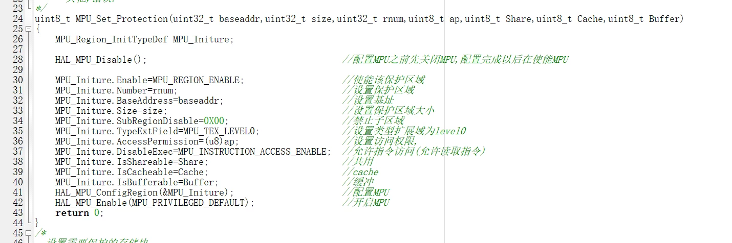

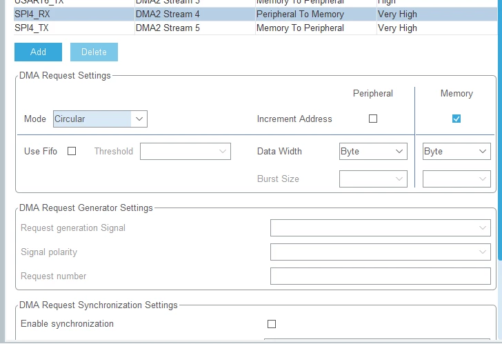

gcaif
gcaifAuthor
September 9, 2019
thank you for you respond.
the below is my configure! can you help me which sides is wrong!
the ​above image is mpu set.
​and the below image is dma set.
and I use USART can tranmit and receive data is correct! so I think the cache is configure suitably.
the ram address is 0x24000000.
