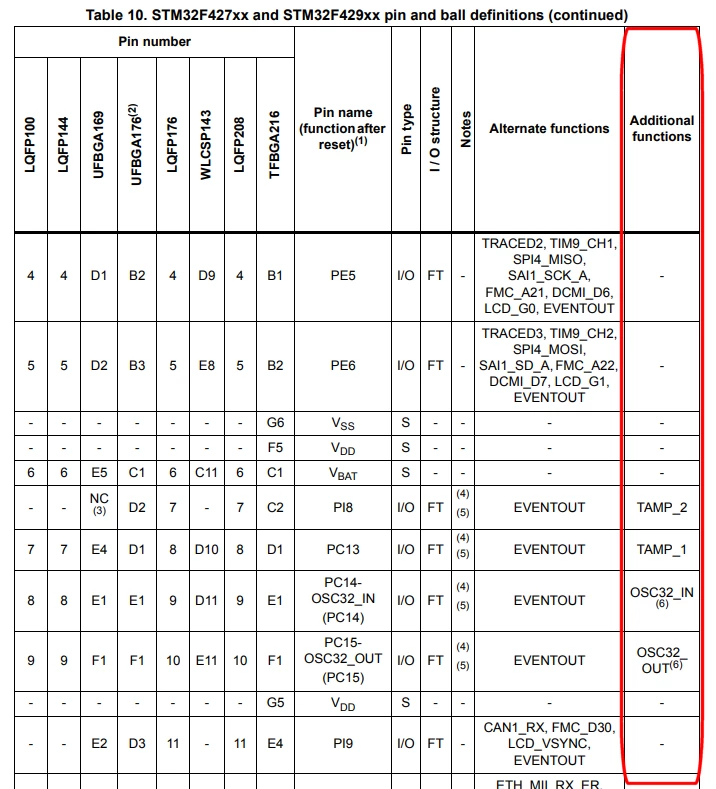

@Tesla DeLorean Hi! Thank you for helping me with the BOOTING process. However, I have a question about the peripherals. I am planning to control a TFT screen that requires 40 pins and RGB protocol. At first, I was planning to choose random GPIOs to build the protocol (I am trying to learn by making it rather than just applying something already built), and I noticed that if I choose to use LTDC, some pins light up, as well as for connectivity like SPI... The pins selected by the IDE to do such tasks have any special characteristics? do they toggle faster? or could I do just the same applying the protocol to any other random set of GPIOs?

Sure, you can use GPIO pins to "bit-bang" any protocol you like (subject to performance limits) - but that requires you to code every single rising edge, delay, falling edge, and sample in code.
That's very heavy on you writing the code, and on the processor having to run it.
Therefore microcontrollers have dedicated hardware blocks for doing common things like SPI, I2C, UART, etc
That relieves both you of having to write, and the processor of having to execute, all that tedious bit-twiddling - you can just pass data to the SPI unit, and it handles it all in hardware.
And hardware can give much higher performance than "manually" twiddling bits by software.
This is general across all microcontrollers - not specific to ST or STM32

Infact, the STM32CubeMX (Standalone version or the one integrated on the STM32CubeIDE) will give a selection of pins that have the necessary Alternate functions (or additional function) to make it work on a specific function (Slave select for SS for SPI, MOSI, MISO,...). Those details can be found on the Table of pin and ball definitions (table 10 of the DS9405 for the STM32F429).
@LucasStartTech it starts on page 53:
https://www.st.com/resource/en/datasheet/stm32f427vg.pdf#page=53
See also Table 12, alternate function mapping - from page 75:
https://www.st.com/resource/en/datasheet/stm32f427vg.pdf#page=75

Just to add to the confusion, STM32 also has "additional functions" - typically for the analogue features.
Typically, these are selected just by enabling the "additional" function.
