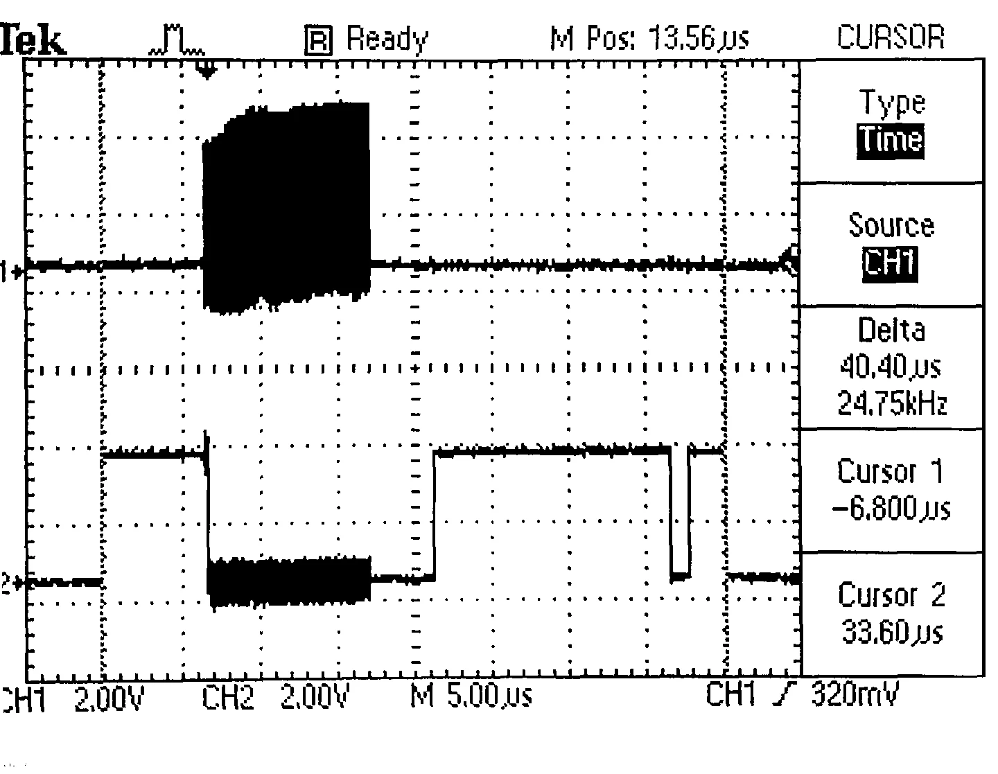

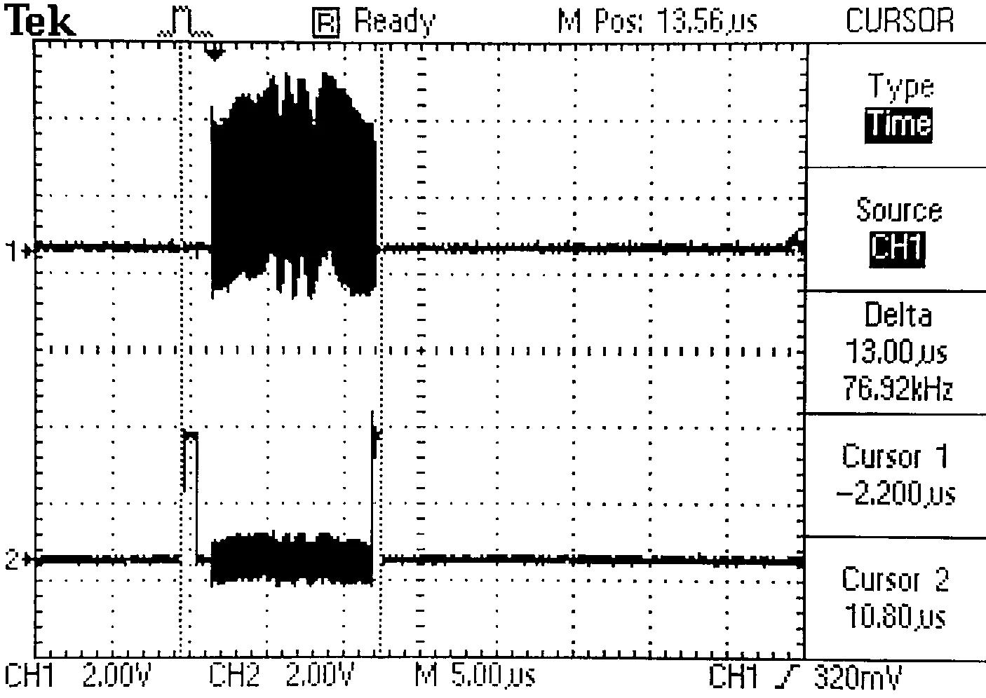

L4R5 120 MHZ: Trace 1 SPI clock (30 MHz), trace 2 Task work: Polling0693W000000X1UNQA0.png
L4R5 120 MHZ: Trace 1 SPI clock, trace 2 Task work: DMA
Before the SPI data: DMA start (DMA was configured before)
After the SPI data: DMA Interrupt handler, task signaling, task switch, and at the end DMA clear.
In this case polling: 13µs, DMA 40%µs
The SPI frequency is fast, the message is short: not suitable for DMA!
And remember: in general, the HAL functions are not fast. It might be better to write your own polling write routine: it's not complicated once HAL has configured the SPI ...
