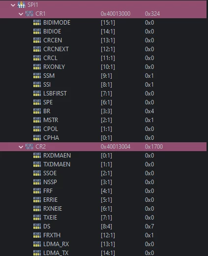

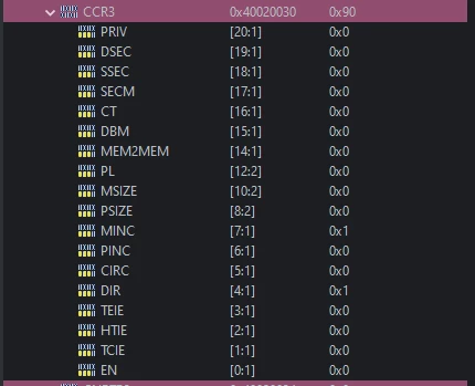

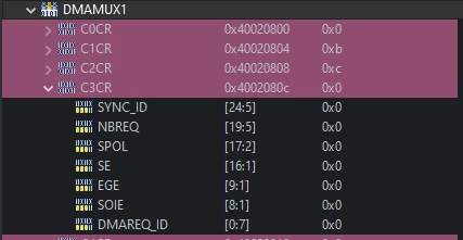

If you are sure GPIO is set correctly, read out and check/post content of SPI and relevant DMA/DMAMUX registers.

These are the register values after running MX_DMA_Init() and MX_SPI1_Init() functions but before running HAL_SPI_TransmitReceive_DMA([...]):0693W00000VOmlSQAT.png0693W00000VOmuxQAD.png0693W00000VOj1VQAT.png
