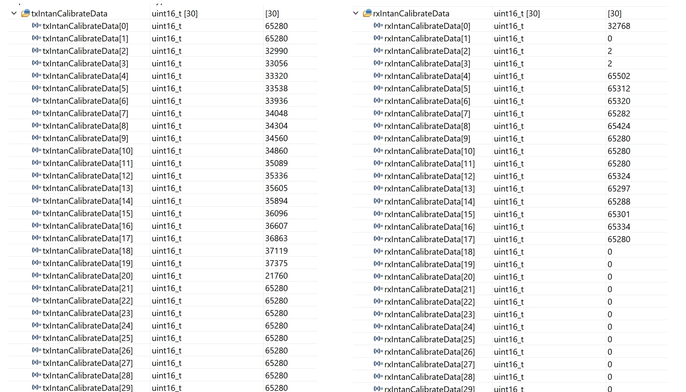

I control an ADC with SPI interface of the STM32F44 microcontroller. The ADC datasheet is in the link, https://intantech.com/files/Intan_RHD2000_series_datasheet.pdf . I set up global variables as read, write, and calibrate masks. The I call them with certain sequence based on the datasheet suggestions. But based on the transmitting values, the receiving value are not matching? For example, how the rx..[2]=2 is possible? Do you have any suggestion about the problem?

for (int i = 0; i < 30; i++) {
HAL_GPIO_WritePin(INTAN_SPI2_CS_GPIO_Port, INTAN_SPI2_CS_Pin, GPIO_PIN_RESET);
hal_status = HAL_SPI_TransmitReceive(&hspi2, (uint8_t*) &txIntanCalibrateData[i], (uint8_t*) &rxIntanCalibrateData[i], 1, 100);
HAL_GPIO_WritePin(INTAN_SPI2_CS_GPIO_Port, INTAN_SPI2_CS_Pin, GPIO_PIN_SET);
HAL_Delay(100);
if (hal_status != HAL_OK) {
printf("HAL SPI TransmitReceive error: %d\r\n", (int) hal_status);
