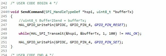

For now, I turn my problem into a simpler situation. in "main.c" file.
This is my pre-define for my function
0693W00000D1asmQAB.jpgthe variable I create inside the main function
0693W00000D1avCQAR.jpgthe place I call the function
0693W00000D1atCQAR.jpgand the function itself (in the main file)
I knew structure and code seems different than my original post. But I thought maybe if I create a simpler environment, I may fix it faster. Still, it turns HardFault at the system.

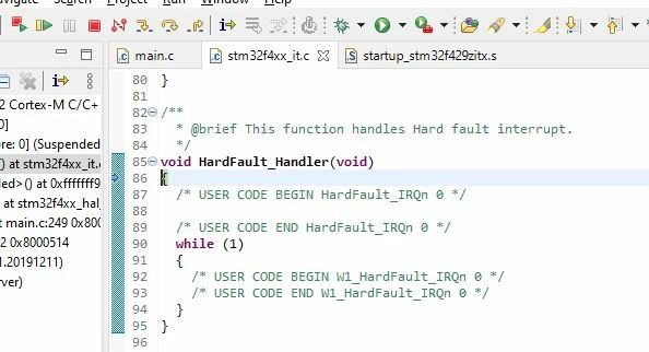

More specifically, when I open debug, press resume this page occurs.
this is the full code. I may not notice important detail, I am waiting for your kind help. :beaming_face_with_smiling_eyes:

void SendCommand(SPI_HandleTypeDef *hspi, uint8_t *bufferTx)
	//uint8_t Buffer2Send = bufferTx;
	HAL_GPIO_WritePin(GPIOC, GPIO_PIN_4, GPIO_PIN_RESET);
	while(HAL_SPI_Transmit(&hspi, &bufferTx, 1, 100) != HAL_OK);
	HAL_GPIO_WritePin(GPIOC, GPIO_PIN_4, GPIO_PIN_SET);

August 5, 2021
You are hopeless. Instead of making the recommended change, you go and change things entirely and introduce new errors.
I don't understand how you are compiling these codes as the compiler won't convert uint8_t to uint8_t * without a warning or error. Those warnings should give you a close as to what's wrong.
Similarly, the compiler won't convert uint8_t ** to uint8_t * without a warning or error.
error: cannot convert 'uint8_t** {aka unsigned char**}' to 'uint8_t* {aka unsigned char*}' for argument '2' to 'HAL_StatusTypeDef HAL_SPI_Transmit(SPI_HandleTypeDef*, uint8_t*, uint16_t, uint32_t)'
How are you not seeing these errors?

August 18, 2021
Maybe it was a little harsh. I apologize.
It’s hard to solve a problem when the goalposts keep moving.
CubeIDE uses the GCC compiler, which absolutely will throw an error with that code. I can’t explain why you’re not seeing it in the console.
