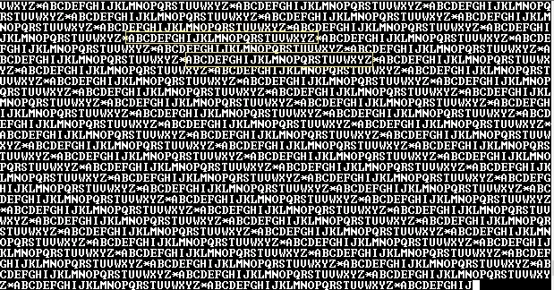

    For more detail .I'll write two program here one of them works good but the next one data will corrupt . i'll attach the result picture;
    ---------------------------------1-Ok----------------------?
    void
    SPI2_IRQHandler(
    void
                if( SPI2->SR & SPI_SR_TXE ){
                    SPI2->DR =
    0xFF
                if( SPI2->SR & SPI_SR_RXNE ){
                    stringBuffer[counterInMaster] = SPI2->DR;
                    counterInMaster++;
                    if(counterInMaster >
    25
                        counterInMaster =
    0
                        stringBuffer[
    26
    \0
                        send2Usart2(stringBuffer);

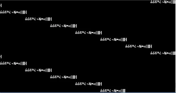

    ------------------------------2-corrupt----------------------?
    void
    SPI2_IRQHandler(
    void
                    SPI2->DR =
    0x41
    any character lead to corrupting data
                    counterInMaster++;
    25
                        counterInMaster =
    0
                        stringBuffer[
    26
    \0

    Jan 28, 2017 8:03 PM UTC
    Posted on January 28, 2017 at 20:03
    Thank you . I took your point . But there is something else here that i can't understand. If my procedure is wrong why in first program it works fine (when i put 0xFF in tx slave buffer ) and when i put any other letter or character in Slave Buffer data will corrupt ?
    And i tried other program ( A lot i mean. I'll put one of them below ) for example I sent some data from Master and in Slave side just send character 'A' .When transferring data from Master to Slave has finished i disabled interrupt and after that sent data to UART but the problem still exists...↓
    -------------------------Problem still exists ------------------------------↓
    void
    SPI2_IRQHandler(
    void
                    SPI2->DR =
    0x41
                    counterInMaster++;
    25
    SPI1->CR2 &= 0<<7;
    // Disable Master interrupt source TXEIE
    SPI1->CR2 &= 0<<6;
    // Disable Master interrupt source RXNEIE // so this part run one time and UART                      rate it's not importanat any more ;
                        counterInMaster =
    0
                        stringBuffer[
    26
    \0
    So how you guys write full duplex transferring with CMSIS and your data won't corrupt ?

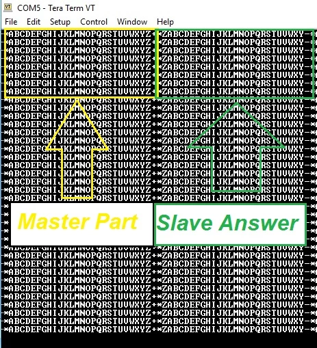

    M N
    M NAuthor
    Jan 29, 2017 4:44 PM UTC
    Posted on January 29, 2017 at 16:44
    I'm using STM32F407 and Both Master and Slave are in one MCU ( but i test it on two board also ).
    I've tested different clock frequency (fpclk/2 ....fpclk/256).And interconnection is not too long because both spi are in same microcontroller in one board . Ground is Ok.Unfortunately i do not have oscilloscope or logic analyzer.
    the code is :↓

    Jan 30, 2017 12:48 AM UTC
    Posted on January 30, 2017 at 00:48
    Thaaaank you ?. after 8 days .now it works.
    About ''Style advices''.Consider it done ,and thank you for your advice (It was easy to writing for me but yes I agree It's hard to read in that way ) But I will change it to your style advice .
    About the ISR , I know it is not good to do heavy process . But i need to see the result and i do not have oscilloscope or logic analyzer so i choose this way or set flag in ISR and do stuff in while loop  ( debug is not good always).But in final project usually I use Flag set or reset in ISR .
    Now It's the result : ?
    Decreasing speed
    setting in OSPEEDR has worked .! How did you know that ? I read reference manual a lot and very carefully (i tried) . But i didn't realize that point.
