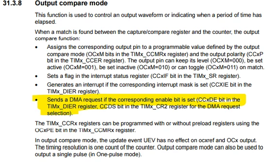

I would be glad to doublecheck with you how to implement the following operation with the STM32L476RG uC:
I would like to transmit a set of data to a DAC (AD5541) with SPI and the SPI data shall be moved from meomory to the SPI peripheral with the DMA. A timer sends the DMA request in order to set the output data rate with the timer threshold value.
I am not sure about a couple of things....so I recap here a todo list to review the procedure:
1) check the system architecture to see which channel of the DMA can receive the request from a timer and which DMA is connected to the different SPIs (If using Cube to init I think this is unnecessary... ).
2) set the Clock, the SPI1 and the Timer1 CH1 with cube to have the initialization code. First question: In cube configuration, shall I add DMA in the SPI tab or in the TIM tab? I think in the timer tab since it sends the request but I would like to be sure

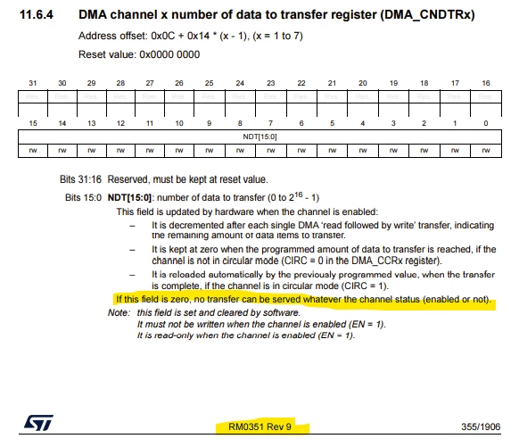

a) DMA1_Channel3 -> CNDTR1 = 0x00000001; // one sample each transfer

4) finally set the TIM register:
a) TIM1 -> CR2 |= 0<<3 // set CCDS=0 to send a DMA when compare event occurs
b) TIM1 -> DIER |= 1<<9 // enable the DMA request when compared
c) not sure how to manage TIM1_CNT and TIM1_CCR1 to set the value be compared. Can you clarify this issue?

Attached you can find a section of the manual that I found useful.
There is no point in setting 1 as DMA transfer length.

"There is no point in setting 1 as DMA transfer length"
Why? The aim was to send one data each time the timer sends the DMA request.

With any NDTR, there is one transfer per request from timer.

Pls check the attached screenshoot from the manual

I meant, NDTR > 1.
The idea of DMA is, that you prepare N data (say N halfwords) into memory, set N into NDTR, set DMA to transfer halfwords, start DMA and start timer. Then upon every request one halfword is transmitted, automatically, without any processor action, until all N halfwords are transmitted, when DMA throws the Transfer complete interrupt.
