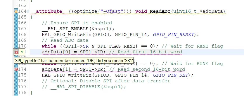

May 27, 2024
hello @JElli.1
I'm using stm32h745. same issue I facing about spi timing. I want to read adc ads7046 this 12bit adc. I used different methods HAL_SPI_Receive(&hspi1, (uint8_t*)&ADC_Value1, 1, HAL_MAX_DELAY);
HAL_SPI_Receive_IT(&hspi1, (uint8_t*)&ADC_Value1, 1);
HAL_SPI_Receive_DMA(&hspi1, (uint8_t*)&ADC_Value1, 1);
But spi is much slow. for polling it taking 5uS when controller clock 400mhz. and is bigger for IT, DMA...

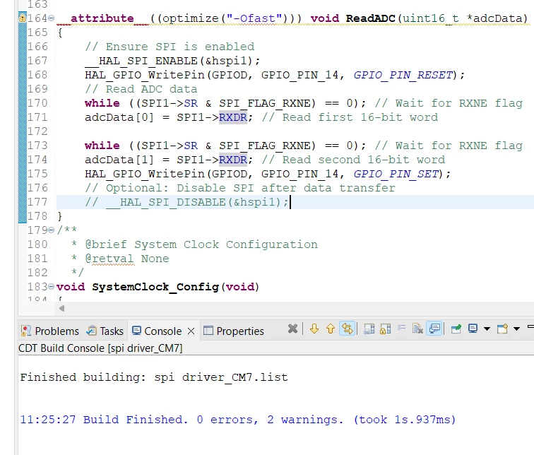

So as your post i want to read direst data register. but i got folloeing errors.
So instead of DR i used RXDR then error solve but output not getting . sclk and cs also not generated means code block at while (( spi1--> sr  line no.170. if i comment line170 to 174 then sclk generated properly
I used setting in stm32cubeide about pin declaration and mode setting, presclare clock and used code generated by stm32cube code generator. so please can you help me where i wrong. i want receive only master.
I need to set pins, mode, clock , presclare all also with register?    Please any example code you have then please can you

__attribute__((optimize("-Ofast"))) void ReadADC(uint16_t *adcData)
 // Ensure SPI is enabled
 __HAL_SPI_ENABLE(&hspi1);
 HAL_GPIO_WritePin(GPIOD, GPIO_PIN_14, GPIO_PIN_RESET);
 // Read ADC data
 while ((SPI1->SR & SPI_FLAG_RXNE) == 0); // Wait for RXNE flag
 adcData[0] = SPI1->RXDR; // Read first 16-bit word
 adcData[1] = SPI1->RXDR; // Read second 16-bit word
 HAL_GPIO_WritePin(GPIOD, GPIO_PIN_14, GPIO_PIN_SET);
