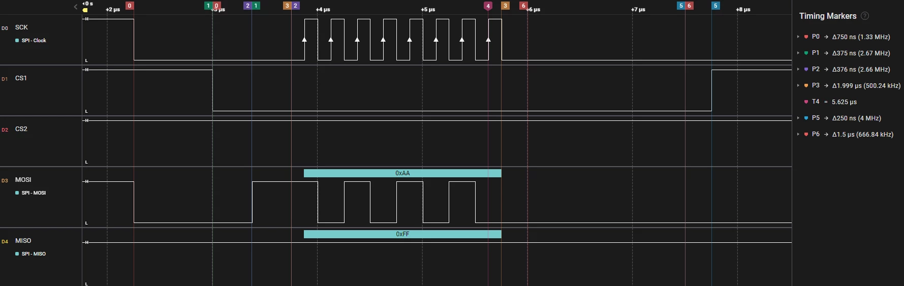

I am familiarizing myself with the SPI controller on a NUCLEO-F303K8 development board using the CMSIS device headers. I have written a program to send and receive a single byte using polling or interrupts. While functionally it appears correct, I am a bit confused on the timing diagrams generated by my logic analyzer.
Overall configuration: System clock is HSI at 8MHz. SPI clock has default prescaler of 2, so 4MHz.
The above is the result for a polling transaction.
Interval 0: SPI enable to CS low, 6 cycles - makes sense
Interval 1: CS low to shift register filled with tx data, 3 cycles (1 CPU cycle to store, 1 SPI cycle to put it on the line?)
Interval 2: Shift register filled with tx data to transaction start, 3 cycles - not sure what happens here
Interval 3: The transaction, 16 CPU/8 SPI cycles - makes sense
Interval 5 (manually added): Reading the shift register and setting CS low - should be 4 cycles (marked it wrong in diagram)
As the SPI is configured with CPOL = CPHA = 0, I would expect RXNE to go high as soon as Marker 4 as the last rx bit is latched, but I suppose there could be more overhead with the FIFO. The left end of Interval 6 is where I would expect the CPU to find RXNE high (a few cycles in a loop), read the shift register, and set CS low, but this does not happen until Interval 5 - around 12 cycles later. Interval 6 is what I'm interested in. I found similar results using interrupts to respond to RXNE.

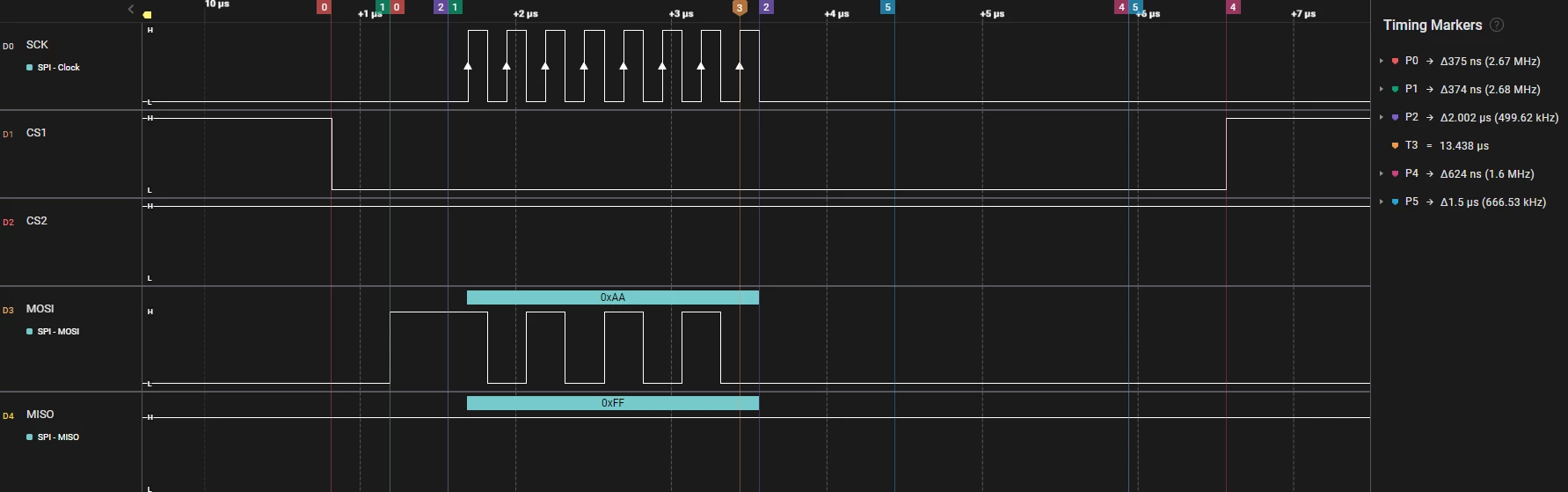

 Above is the interrupt transaction. Similar intervals are highlighted, although Interval 5 and Interval 4 make up the expected Cortex M4 interrupt latency (12 cycles) and reading the shift register/setting CS low, respectively. The interval of interest here is Marker 3 to the left end of Interval 5.
Finally, here is the code.

This is not your friendly microcontroller anymore, it's an SoC, with all the consequences.
First, you should be looking at disasm, not the C source.
Then, instruction execution is not single-cycle. You may have cheated the FLASH latency by running at low clock, but jumps take more than single cycle. Plus, whatever data are read by instruction, the instruction must wait until the system provides that data (writes too, but they generally are faster due to buffers at various points of system, so you won't see slowdown until you write twice in a row).
SPI is on an APB bus, beyond the S-port of processor, the bus-matrix, and an AHB-to-APB bridge. Add one cycle for each of these, maybe two for the AHB-APB bridge for reading (?) these things are not very well publicly documented (read: not at all).
Welcome to the glorious world of 32-bitters.

Thanks for the detailed response; I figured there was a lot of complexity that I made too many assumptions about. I was primarily looking at the disasm when I made the post (just posted the C source because I don't know if people want to see the asm,) but as you have said, not all instructions will complete in a cycle and I did not take into account the peripheral bridges. I was indeed cheating the flash latency by running at 8MHz, so I didn't consider any wait states.
The article you linked was very helpful; I definitely underestimated the complexity of these systems and will have to rethink the way I work on them. That being said, is there actually any documentation on these sorts of low-level things? I know, for example, these buses are described in the AMBA specifications and ports in the architecture manuals, but manufacturers have their own implementations, right? If there is documentation, will reading it allow me to know the exact latencies? Does knowing about these things allow me to write better code to take advantage of it, or is it simply too obscure/insignificant to worry about? Premature optimization is evil and all; I might just be in over my head.

I forgot to consider a DMA transfer as well. I set up a routine to use the RX DMA channel and transfer complete interrupt to transmit and receive a byte, which should be functionally equivalent to using RXNE and the SPI interrupt. I found similar results to the normal interrupt method, but DMA will obviously be the go-to for transfers with more than a few bytes.
