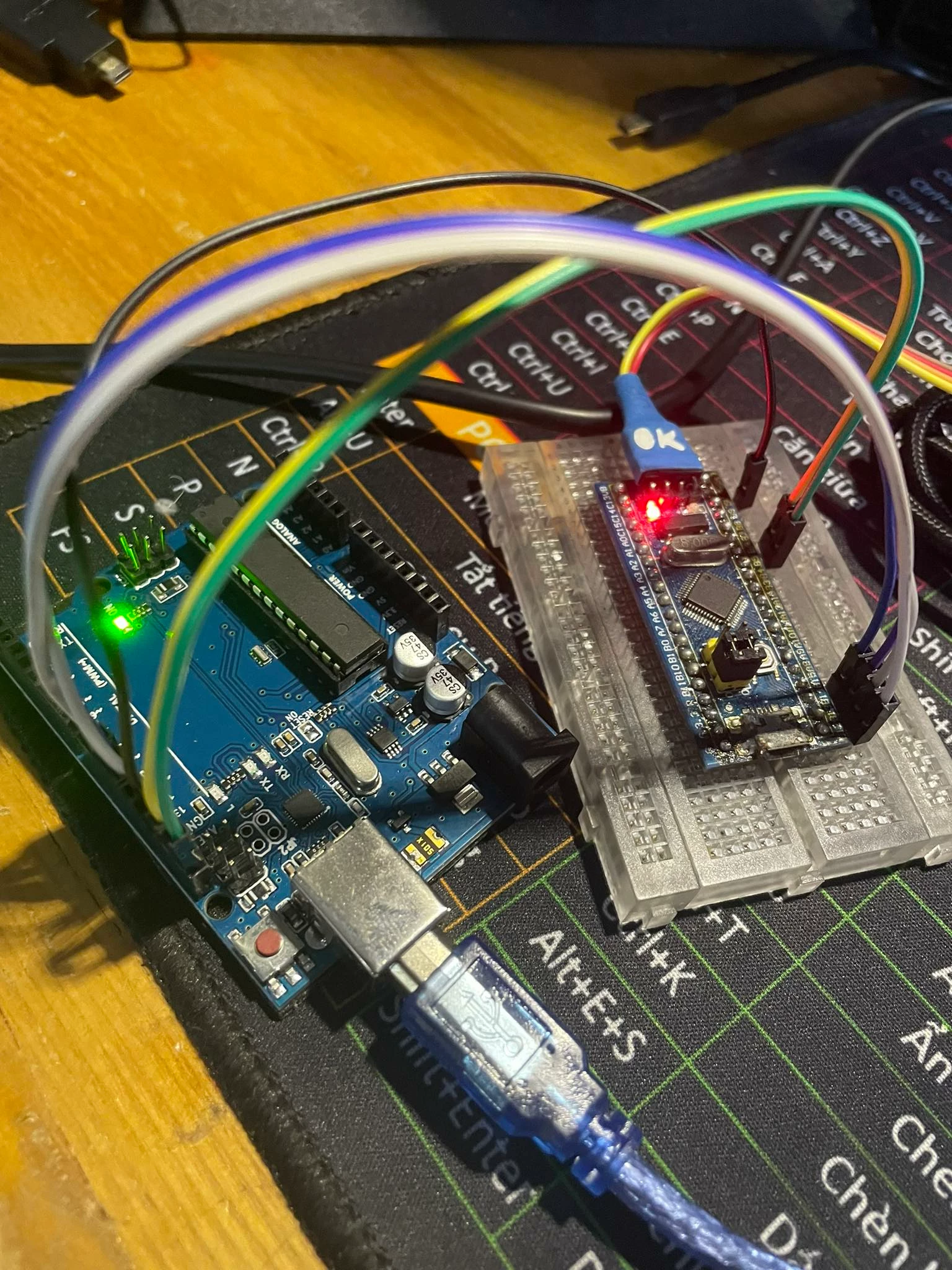

My problem is the SPI communication between the blue pill board STM32F103C8T6 (slave) and the Arduino Uno R3 board (master). Here is my setup:

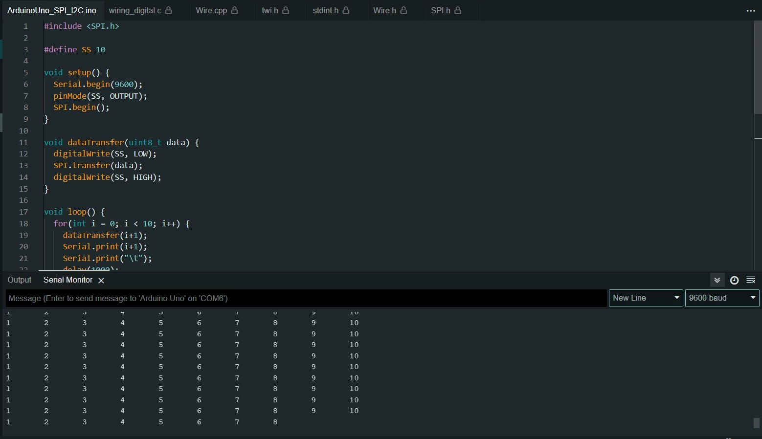

1. For arduino:
The code:
#include <SPI.h>
#define SS 10
void setup() {
  Serial.begin(9600);
  pinMode(SS, OUTPUT);
  SPI.begin();
void dataTransfer(uint8_t data) {
  digitalWrite(SS, LOW);
  SPI.transfer(data);
  digitalWrite(SS, HIGH);
void loop() {
  for(int i = 0; i < 10; i++) {
    dataTransfer(i+1);
    Serial.print(i+1);
    Serial.print("\t");
    delay(1000);
  Serial.print("\n");

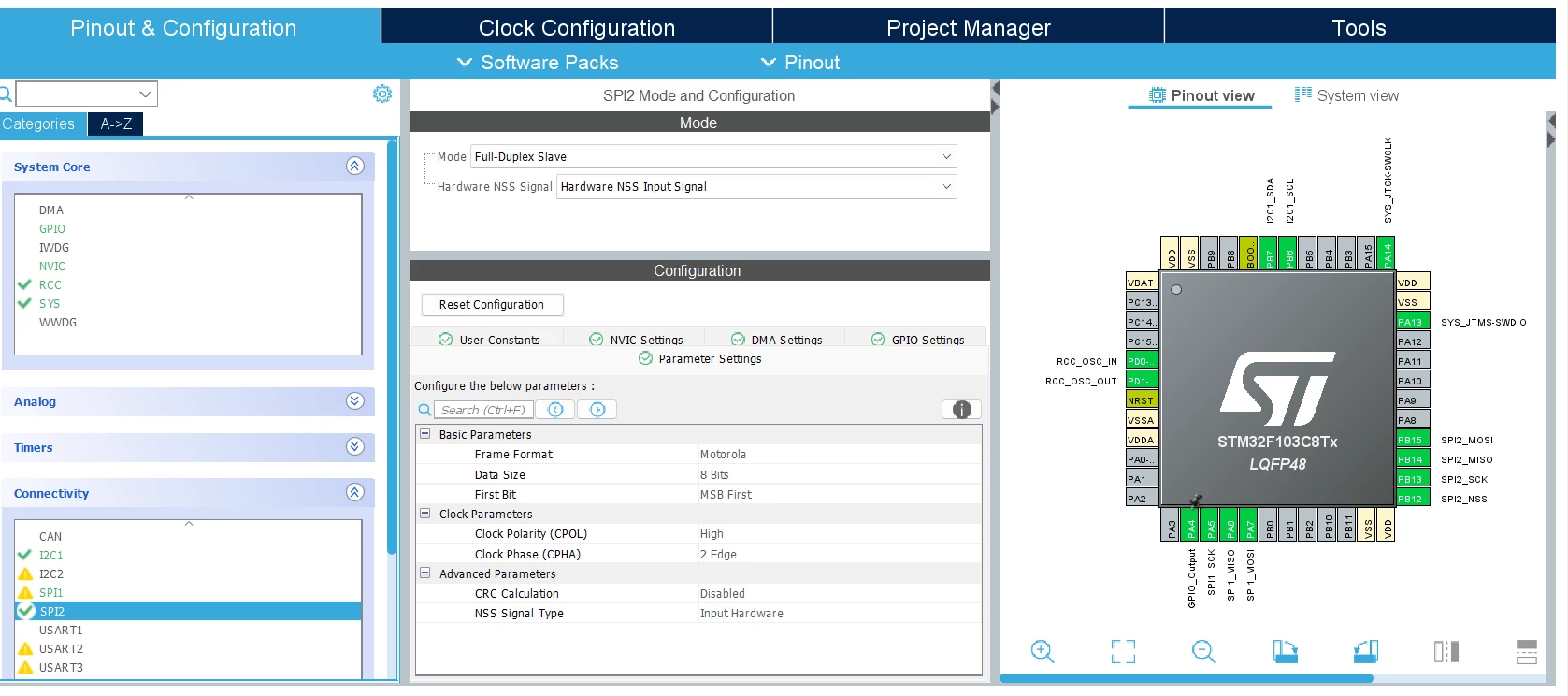

Here is my SPI2 configuration:

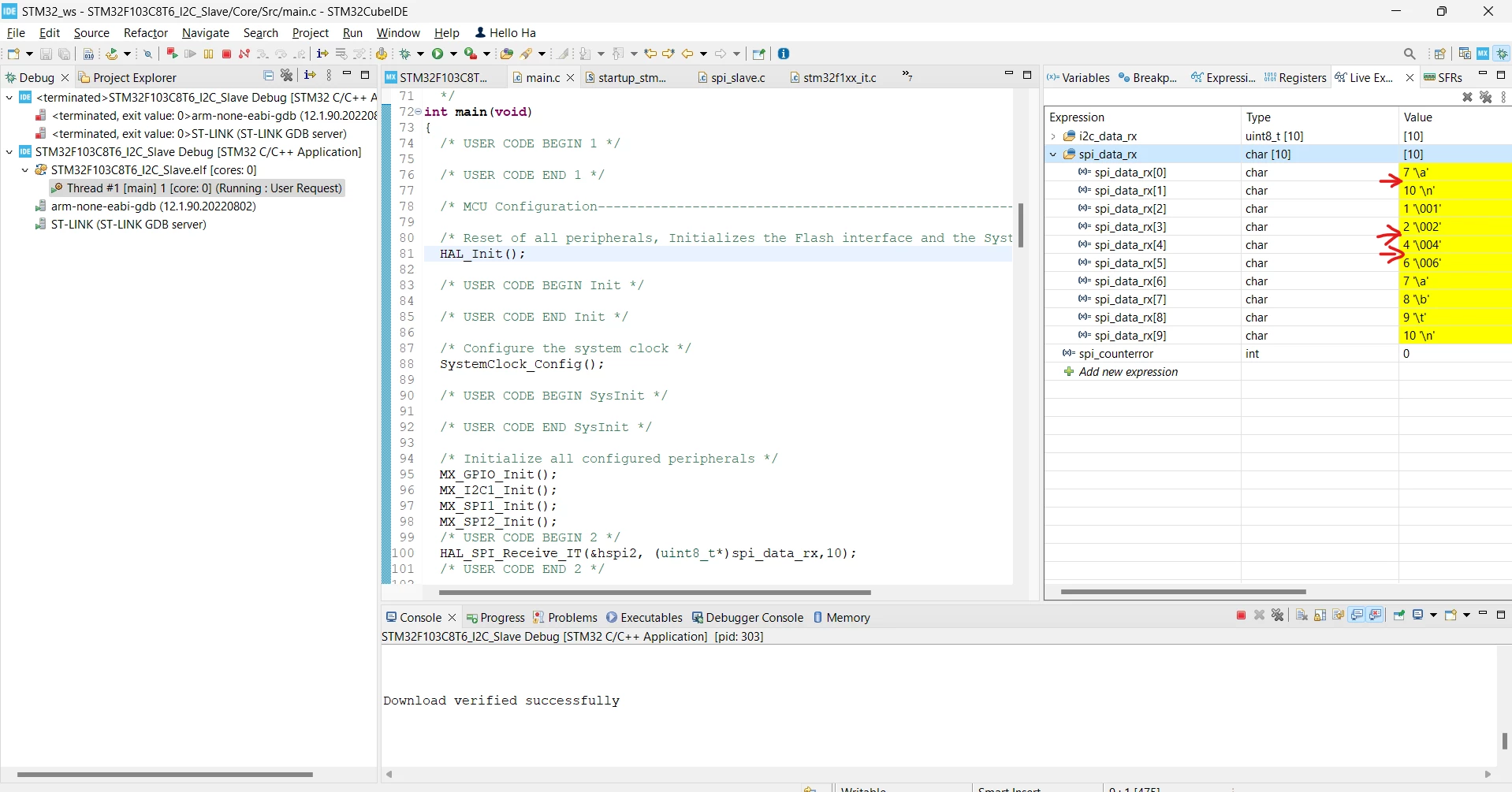

 Though I send 10 numbers from Arduino, I still miss some numbers when my stm32 reads them
 3. Some useful images:giangthewalkingman_0-1716318265071.pnggiangthewalkingman_1-1716318436890.png

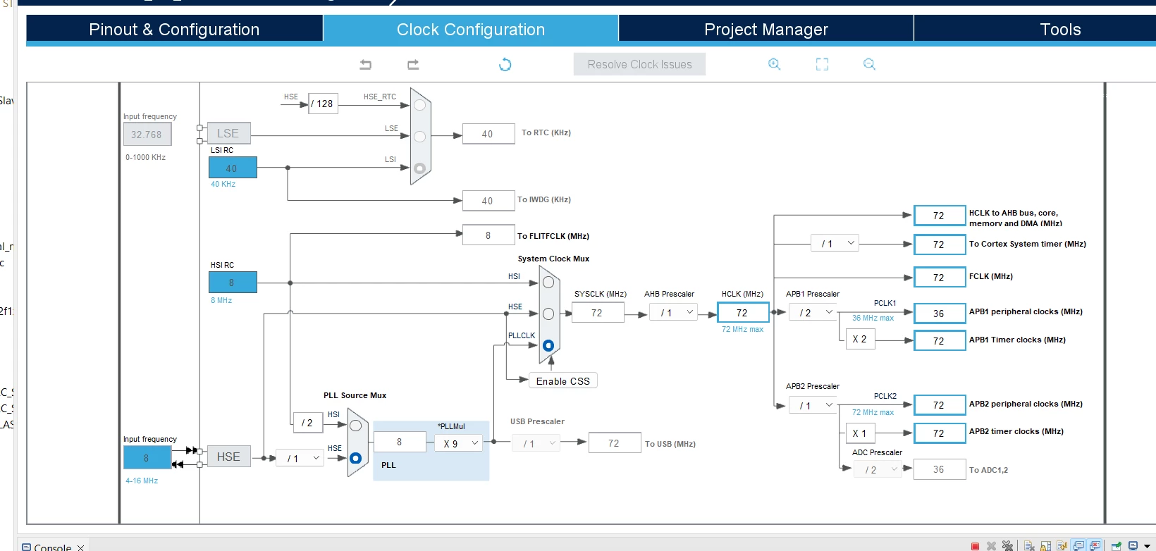

STM32 clock configuration:

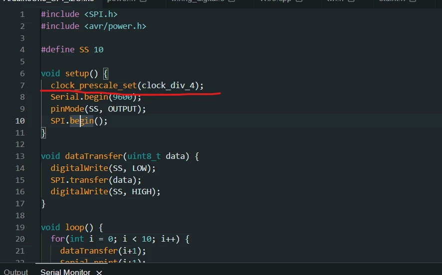

Try to lower the baudrate.
giangthewalkingman
May 22, 2024
I tried lower the speed of Arduino clock about 2 or 4 times, but there is no use, the stm32 still misses the data.

Please ensure that the GND (ground) pin of the Arduino board is connected to the GND pin of the STM32 board.
In order to give better visibility on the answered topics, please click on 'Best answer' on the reply which solved your issue or answered your question. Saket_Om
giangthewalkingman
May 22, 2024
Thanks, but the hardware connect doesn't matter. I connect both SPI and I2C, the I2C works okay, but the SPI is very problematic :(((
