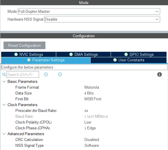

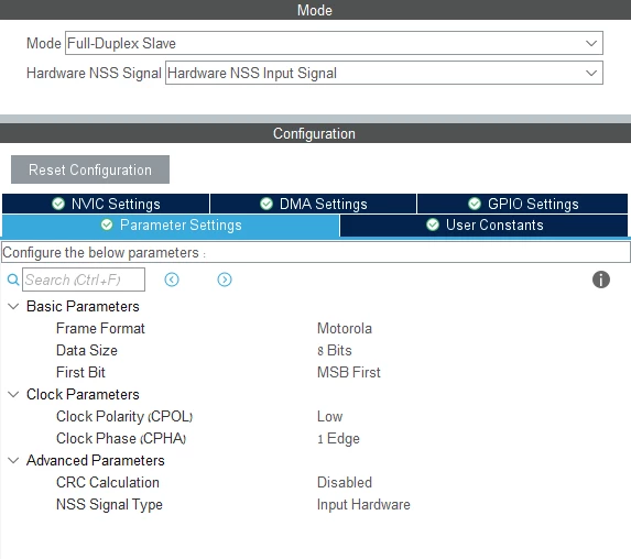

I am using 2 boards with SPI communication between them: STM32F412G-DISCO as the master, NUCLEO-G071RB as the slave. The MOSI direction works well, but the MISO direction doesn't works. Monitoring the MISO line via. oscilloscope shows that there is no communication in this line, also it is expected to be.
The boards configuration:
The master code:
HAL_GPIO_WritePin(GPIOC, GPIO_PIN_2, GPIO_PIN_RESET);
HAL_SPI_Transmit(&hspi1, (uint8_t *)&spi_tx, 2,100);
HAL_SPI_Receive(&hspi1, (uint8_t *)&spi_rx, 2,100);
HAL_GPIO_WritePin(GPIOC, GPIO_PIN_2, GPIO_PIN_SET);
The slave code:
HAL_SPI_Receive_IT(&hspi1,(uint8_t *)&spi_rx,2);
HAL_SPI_Transmit_IT(&hspi1, (uint8_t *)&spi_tx,2);
void HAL_SPI_RxCpltCallback (SPI_HandleTypeDef * hspi) {
counter++;
if (counter==10) {
counter=0;
sprintf(spi_tx,"c%d",counter);
for(int i=0;i<4;i++) {
spi_buf[counter*2+i]=spi_rx[i];
void HAL_SPI_TxCpltCallback (SPI_HandleTypeDef * hspi) {

1. for transmit + receive (at same time) use :  HAL_SPI_TransmitReceive_IT(..);
2. just for transmitting 2 bytes : why not set the spi to 16bit and do it in one spi transfer?
3. using NSS hardware on receiver, but nss-software on transmitter...might create problem, if you dont do in software, what other chip spi-hardware expects. Try setting both to hardware nss. And use TransmitReceive on both sides.
