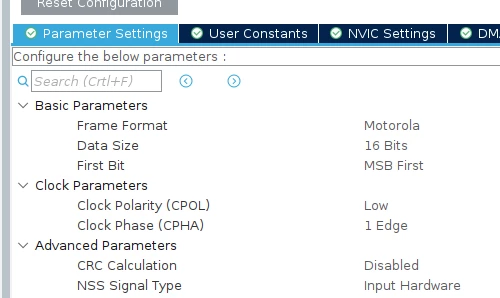

I am working on SPI slave at NUCLEO-F767ZI.
I am using the interrupt and LL library. This is the RX handler:
void SPI1_Rx_Callback(void) {
 if (LL_SPI_GetRxFIFOLevel(SPI1) > LL_SPI_RX_FIFO_HALF_FULL)
 // this is only for break point
 spi1_rx = LL_SPI_ReceiveData16(SPI1);
 return;
 spi1_tx = spi1_rx;
 LL_SPI_TransmitData16(SPI1, spi1_tx);
It just echos. The master sends 70 bytes data with no delay or gap until the end of the transmission. I put a break point in the line of 5 in the above code. When the master sends the data in 1MHz, it never go into the break point. But if I increase it to 2MHz, it stops in the break point. I think 2MHz is not that fast speed in SPI bus. How can I fix this?
  • sysclk: 96MHz
  • Here is SPI1 setting:0693W00000aHByoQAG.png

KnarfB
February 20, 2023
Its easy to get interrupt latencies >1µs especially if you work with the HAL callback mechanism and not the bare IRQ handlers. A typical approach could read from RX FIFO in a while loop to drain the FIFO as quickly as possible. Another approach would be using DMA which seems preferrable here because the master sends short bursts (of predictable max. length?) of data.
hth

YoungKim
YoungKimAuthor
February 20, 2023
The SPI slave application should respond as soon as possible whenever it receives 16 bits register. therefore the DMA solution may not be suitable. Is my understanding correct?
And I can't use while loop solution because I am running multiple tasks by using FreeRTOS.
I want to use bare IRQ handler. I will try and get back here with the result. Thanks @KnarfB​  and @F.Belaid​

YoungKim
YoungKimAuthor
February 21, 2023
I found this from the RM0410 reference manual:
It is preferable for the slave to use DMA, especially when data frames are shorter and
bus rate is high.
