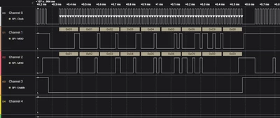

Hello community ,
I have programmed stm32g030k06t6 MCU has SPI Slave . When trying to communicate with master for 10 times , 6 times checksum is getting failed and 4 times it is getting passed .
Master is sending 9 bytes of data i.e 0x1,0x2,0x3,0x4,0x5,0x6,0xc9,0x00,0x3 . when checksum is getting failed it is getting saved in buffer in following order 0x3,0x1,0x2,0x3,0x4,0x5,0x6,0xc9,0x00. one byte is getting shifted in rx_buffer when storing
Inorder to analyse the problem , i am copying rx_buffer to tx_buffer in order to analyse better where snaps are attached below .
kindly suggest

Checksum failing packet sample
Checksum pass sample

I'm unsure but I think that MOSI - Master Out Slave In is stored data correctly.
In image is start with 0x03 so that it get correct on.
So it's possible that master are do wrong.
another thing is I'm unsure what kind of this protocol. It's like as the MCU has free to exchange the data directly.
there is no any protocol as something like read or write command.

it is SPI communication . I programmed SPI Slave, i used External pin interrupt as chip select where it enables and disables the SPI slave and talk to master .
SPI data is not saving correctly in rx_buffer . 0x03 should be at the end of the rx_buffer

but from this image
it's start with 0x03.

Hi @Tinnagit ,
Channel 1 is MISO (it is the output from slave) .Here i am sending back the data which is received from master .

Nchun.1AuthorBest answer
November 20, 2023
Hello Community ,
The issue is resolved now after increasing SPI clock speed .
Thank you
