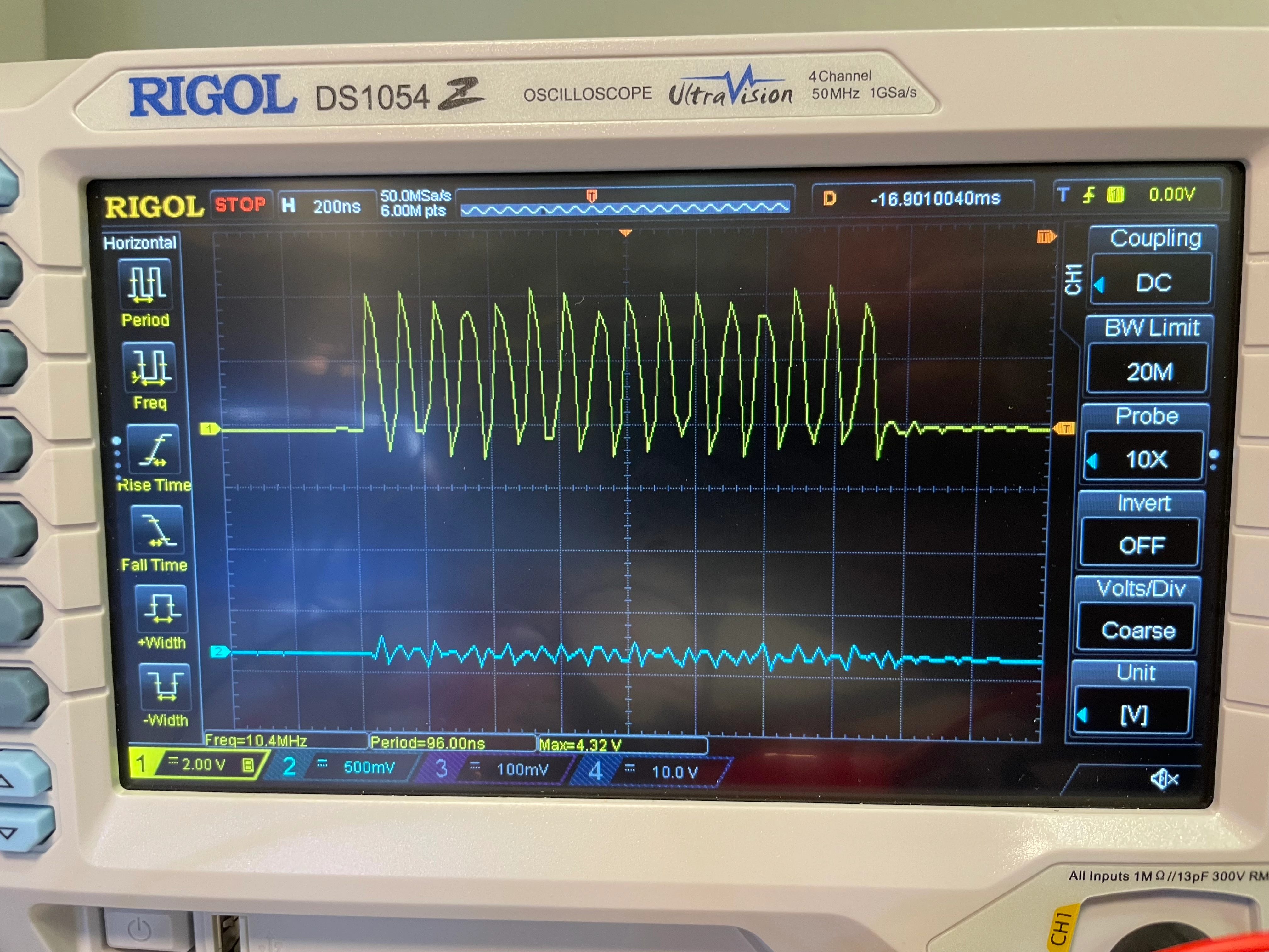

I am try to control an external DAC system with the SPI interface. The clock signal shape looks like the attached file. I didn't figure out the meaning of the signal. Yellow is the clock signal and the blue is CS signal.0693W00000aJE10QAG.jpg

yes. Need to change to something useful. set -> button Aquire-> mode:normal, mem-depth: auto , anti-alias:off ; + buton Display -> type: vector .
set your probe to x10 , an in dso probe menu also x10 setting.
(and it was NOT default setting ! )
if want some gaming: just try -- press button AUTO , with signal active; scope tries to set it then automatic good.

better.
probe still at x1 ! you cannot test cmos connections at > 10MHz with x1 probe setting.
set x10 at probe switch and in scope menu.

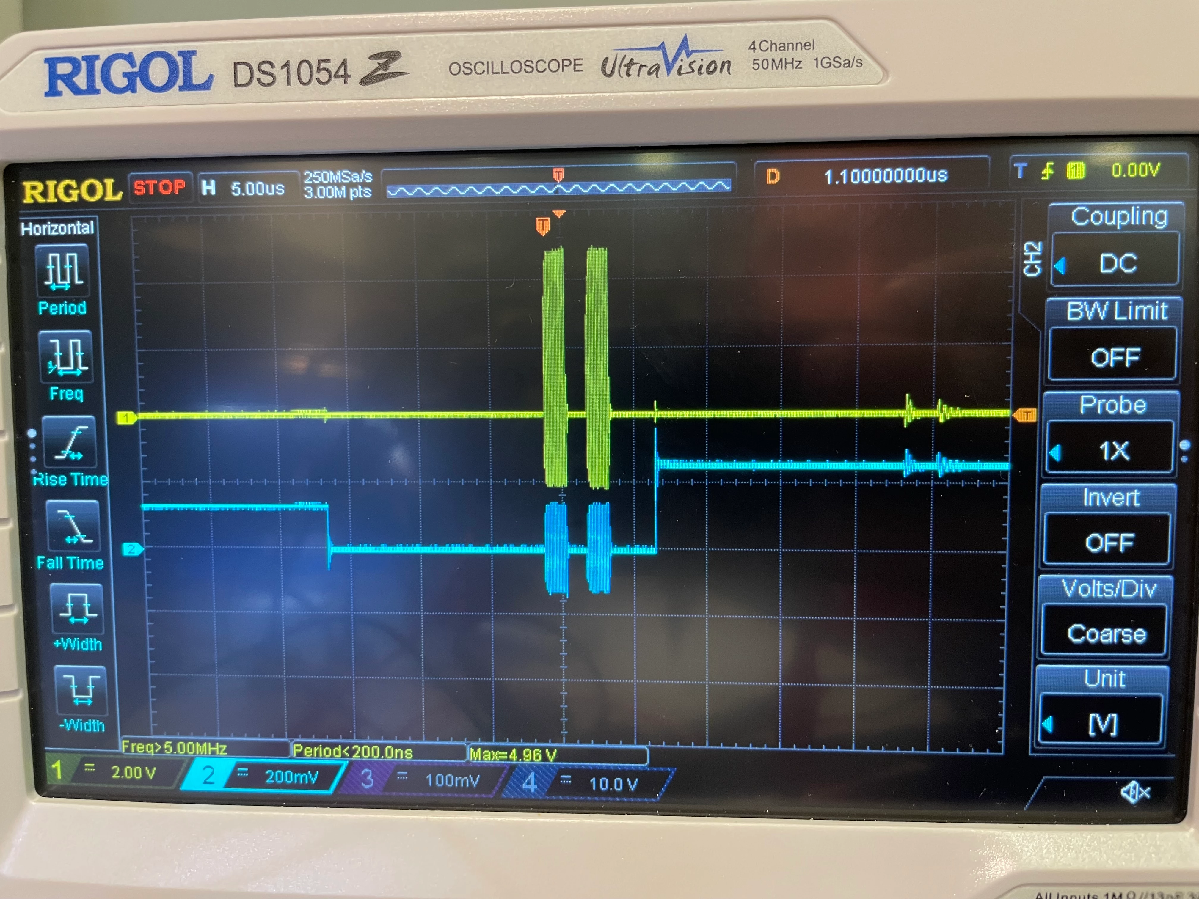

I set the 10x both the probe and settings in the oscilloscope.

x10 probe setting needs adjustment - did you adjust ?
+ BW limit 20 M is set.
do you make some game here ? who is the biggest idiot ? or what ?
sorry.
want help - or play game ?

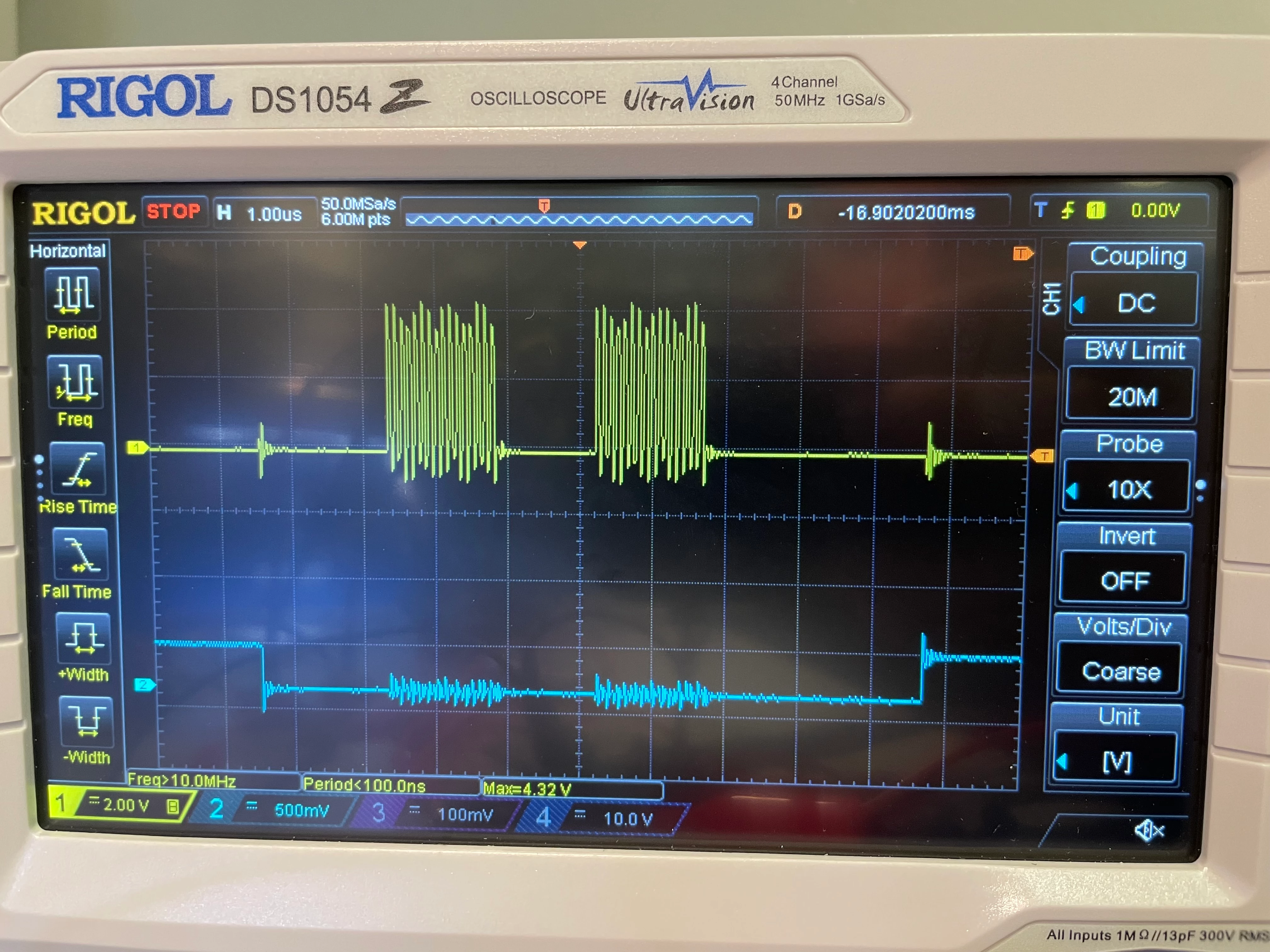

No game. What adjustment do I need?
AScha.3
March 17, 2023
bw limit off.
and adjust probes - i hope you know how to do.

Yes I did it.

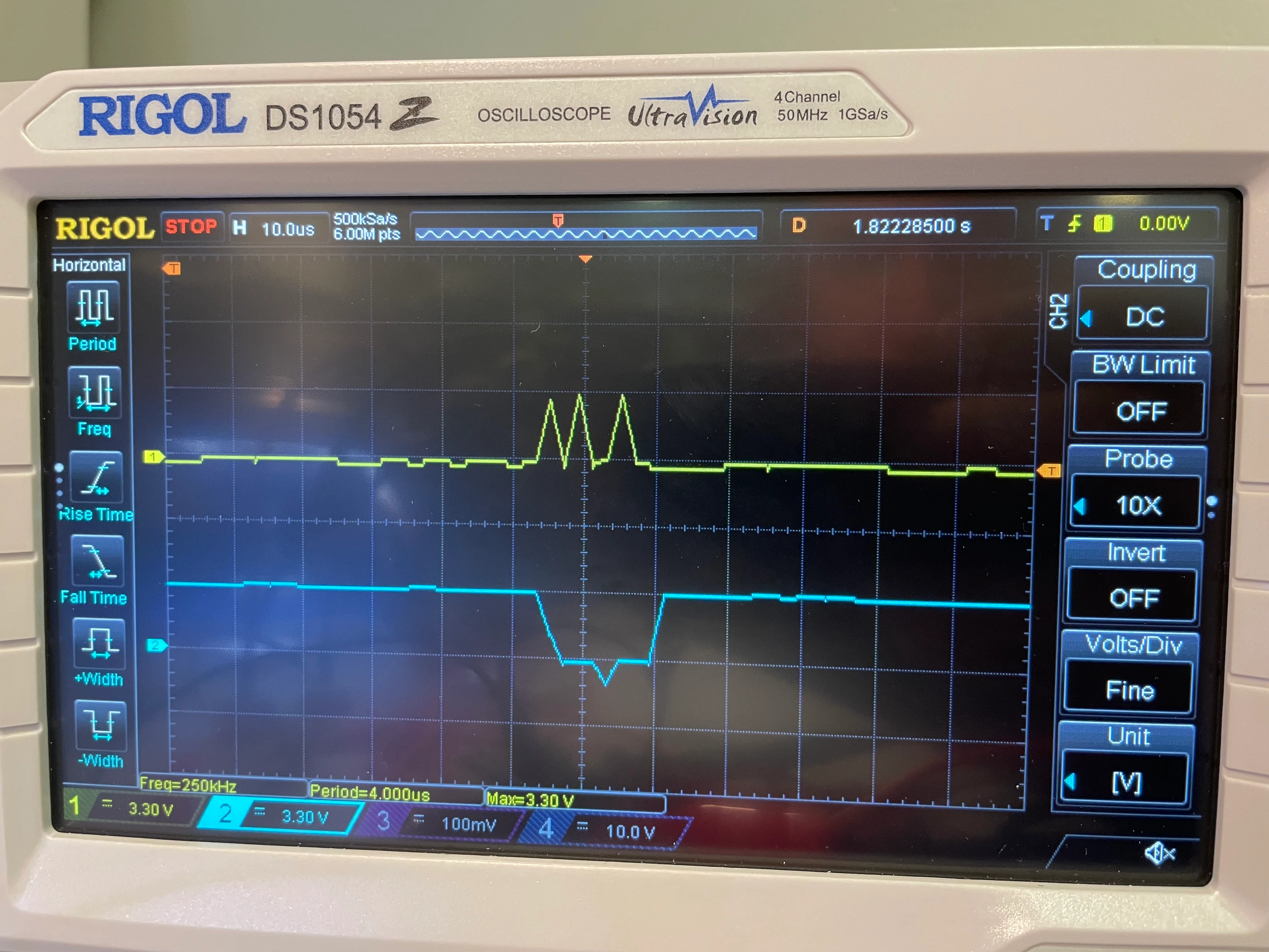

This is the latest measurement that I have.

again sample rate much too low. 500 ks - how you do this ?
or do you make "SINGLE" shot and then turn around the timing? this could make such pictures.
show a measurement without any change or "adjustment" after the single shot.

Sorry for late reply. Honestly, I don't know, for example now the sampling rate of the oscilloscope is 1 GSa/s.
You're right. I captured only this zoom in figure. Before zoomed in, it was square wave.
