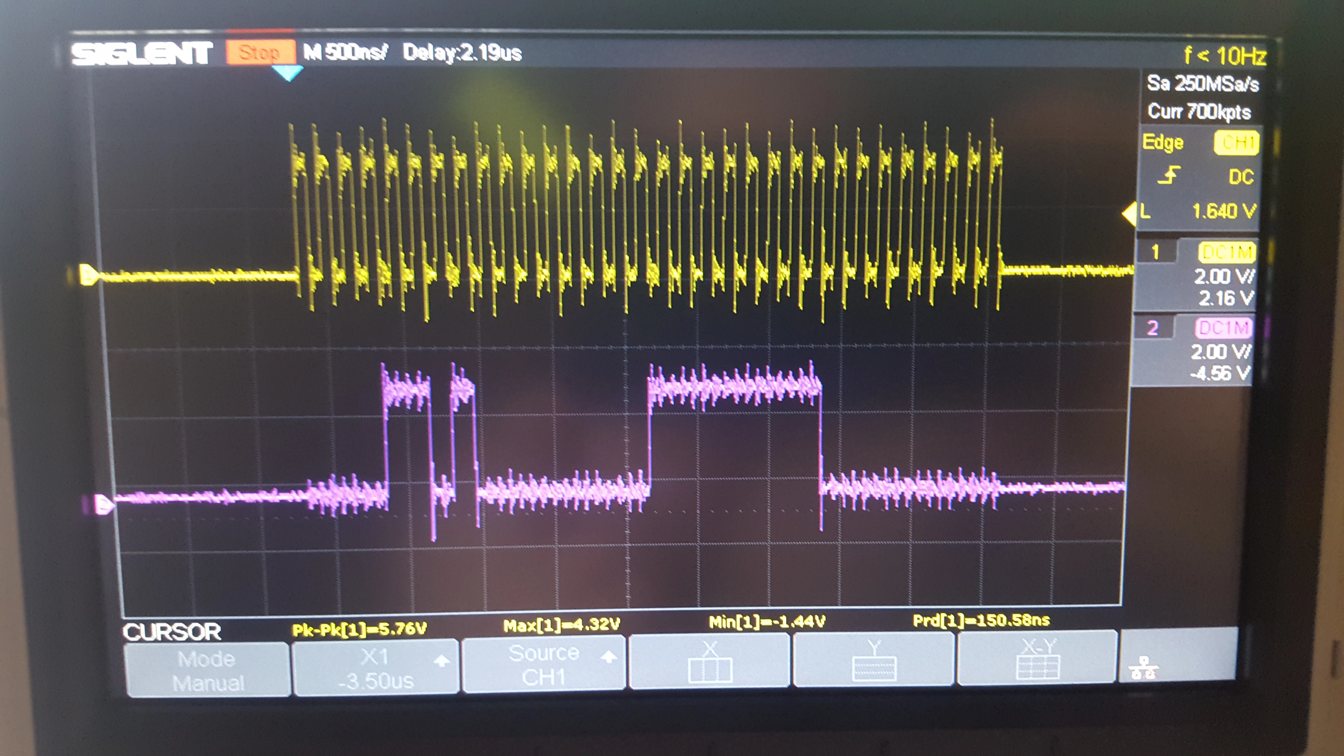

I'm trying to initialize SPI on STM32F746ZG-nucleo and send some data.
When i check with oscilloscope it shows an extra 0x00 packet at the end of each transmission.
I can't figure out why, please help.
#include ''stm32f7xx.h''
void SPI2_tx(uint8_t data){
  SPI2->DR = data;
  while(!(SPI2->SR & 2));}
uint8_t SPI2_rx(void){
  while(!(SPI2->SR & 1));
  return(SPI2->DR);}
int main(void){
  uint8_t asd;
  RCC->AHB1ENR |= (1<<2)|(1<<3);                //c,d
  RCC->APB1ENR |= (1<<14);                      //spi2
  GPIOC->MODER |= (2<<4)|(2<<6)|1;              //  0,2,3
  GPIOC->OSPEEDR |= 3|(3<<4)|(3<<6);
  GPIOC->AFR[0] |= (5<<8)|(5<<12);
  GPIOD->MODER |= (2<<6);                       //  3
  GPIOD->OSPEEDR |= (3<<6);
  GPIOD->AFR[0] |= (5<<12);
  GPIOC->ODR |= 1;                              //spics
  SPI2->CR2 = 0x1704;
  SPI2->CR1 = 0x0354;
  SPI2_tx(0x0D);
  SPI2_tx(0xFF);
  asd=SPI2->DR;
while(1);}

    waclawek.jan
    July 6, 2018
    Posted on July 06, 2018 at 08:20
    The newer STM32's SPI transmits two bytes if you write (unknowingly) a halfword into the data register. Typecast the DR register to 8-bit
    *(volatile * uint8_t)&SPI2->DR = data;
    See 'Data packing' in the SPI chapter of RM (and/or look it up here, this is a common gotcha).
