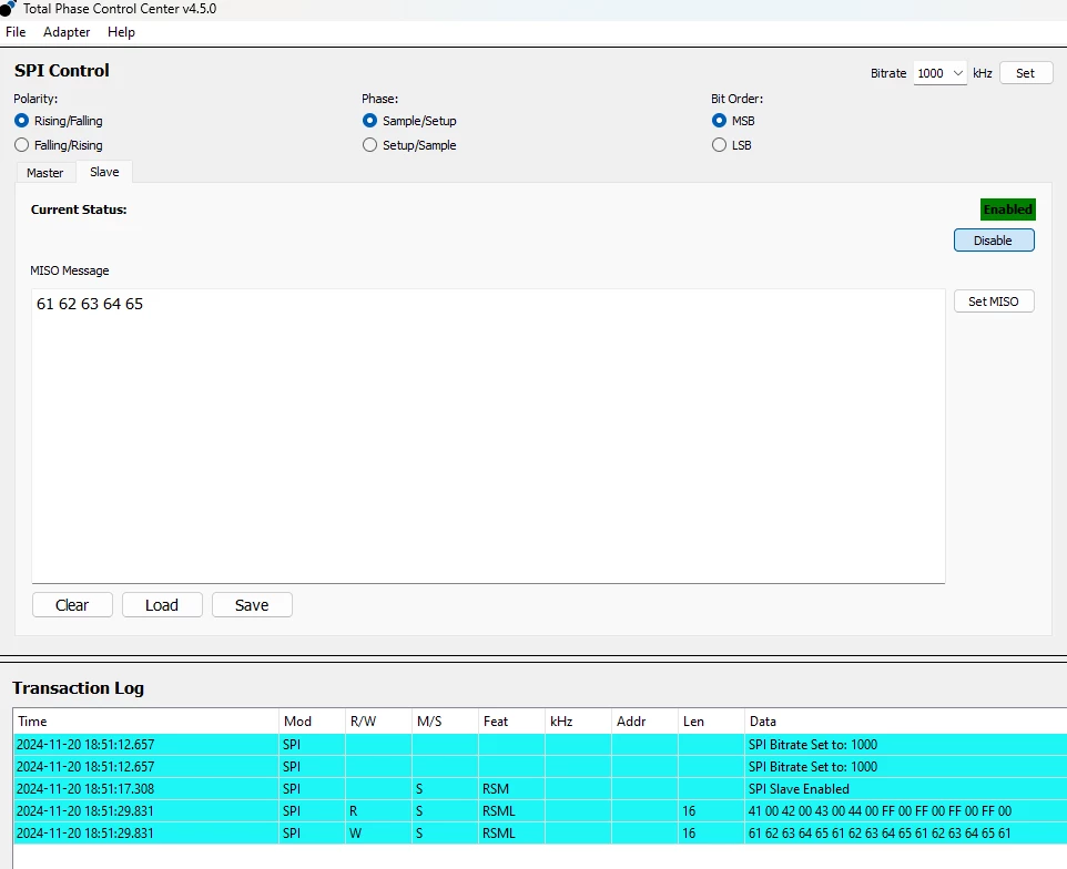

I doing bare metal coding for STM32L496ZGT6. Now in SPI, extra bytes are sent. There are only 4 Registers in SPI but unable to resolve the issue. Below is my code
NOTE:
I am using Aardwark Total Phase Control Center software for debugging. I am attaching the related images. The Chip select to be handled by the SPI Hardware.

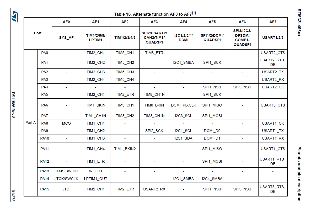

Data sheet is DS11585.

GPIOA->AFR[0] |= (5 << 20) | (5 << 24) | (5 << 28); // AF5 for SPI1
// Configure PA4 for SPI1_NSS (CS) (This can remain as an alternate function pin)
GPIOA->MODER &= ~(3 << 8); // Clear mode for PA4
GPIOA->MODER |= (2 << 8); // Set PA4 to alternate function mode
GPIOA->AFR[0] |= (5 << 16); // AF5 for SPI1_NSS
I want to know the 00 or FF is stuffed for every byte sent or received.

Don't know about TotalPhase, but a $10 logic analyzer could show the signals on the wire.
In CR2, FRXTH bit must be set when using 8-bit transfers.
DR register is 16-bit wide. When reading/writing 8-bit values DR register must be type-casted:
*(__IO uint8_t *)(&SPI1->DR) = tx[i];
 rx[i] = *(__IO uint8_t *)(&SPI1->DR);
Check disassembly, you should see byte transfers now. __IO is a macro which expands to volatile.

@vbk22398 wrote:
Not sure exactly what you're showing there?
Are you sure the 00 or FF aren't just "dummies" displayed by the TotalPhase tools while one line is idle?
Would be helpful to see a corresponding logic analyser style view of the MOSI, MISO, and clock lines ...
PS:
for example:
How would the "Transaction Log" display that interaction?
Would it show the data on MOSI as "XX 00", and the data on MISO as "00 XX" ?
In both cases, the 00 is just the "line idle" state, when the transmitter has nothing to send - but the line can't be at a "nothing" state - it has to be either high or low, so reads as 00 or FF
This is standard SPI operation.
