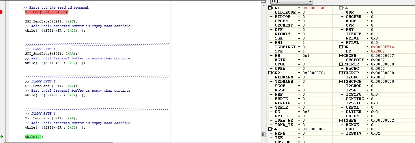

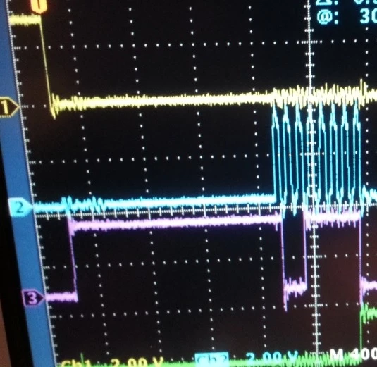

    I see my command 0x9F being sent out on the oscilloscope, but the code hangs at the last line waiting for a received byte.
            SPI_Cmd(SPI1, ENABLE);
            // Wait until transmit buffer is empty
            while(  !(SPI1->SR & 0x02)  );
            // Send the first byte
            SPI_SendData8(SPI1, 0x9F);
            // Wait to receive the first byte back.  - hangs here.
            while(  !(SPI1->SR & 0x01)  );
    mikemillernow
    April 1, 2014
    Posted on April 01, 2014 at 04:04

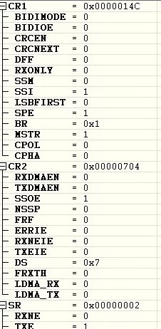

    Below are the SPI1 register settings:
    Here if I see 8 clock edges, and the data being sent out I should be seeing something received.  Even if the data is all zero or FF's I shouldn't get stuck in this loop.

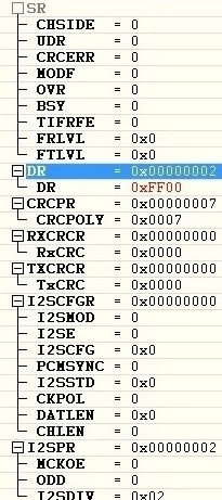

    More debugging:
    If I keep the following line below uncommented after my dummy write the code hangs''  while(  !(SPI1->SR & 0x01)  ); ''
    If I comment that code out and  if I do several reads back to back I see the correct data on the 5th read of the data register.  There has to be a better way!
       received[0] = SPI1->DR;
            received[1] = SPI1->DR;
            received[2] = SPI1->DR;
            received[3] = SPI1->DR;
         SPI_SendData8(SPI1, 0x05);
          // Here is where I need to check to be sure that the read-> is empty.
          received[0] = SPI1->DR;                   // Reading back 0x00 but 0xFF on the scope.
          received[1] = SPI1->DR;                   // Reading back 0x00 but 0xFF on the scope.
          received[2] = SPI1->DR;                   // Reading back 0xFF but 0xFF on the scope.
          received[3] = SPI1->DR;                   // Reading back 0xFF but 0xFF on the scope.
          // Dummy data to read status register out
          SPI_SendData8(SPI1, 0xAA);
          // Wait until there is data in the receiver buffer and continue.
          while(  !(SPI1->SR & 0x01)  );                  // hangs here if uncommented!
          received[4] = SPI1->DR;                   // Reading back 0xFF but 0x02 on the scope.
          received[5] = SPI1->DR;                   // Reading back 0xFF but 0x02 on the scope.
          received[6] = SPI1->DR;                   // Reading back 0x02 but 0x02 on the scope.
          received[7] = SPI1->DR;                   // Reading back 0x02 but 0x02 on the scope.
          received[8] = SPI1->DR;                   // I see the correct data here.

    stm322399
    Senior
    April 1, 2014
    Posted on April 01, 2014 at 10:26
    Mike,
    I'am sorry for only making assumptions here, I hope it will help anyway.
    There are two things you may consider:
    1) accessing SPI1->DR to copy into a byte array is a bad idea because, DR is 16-bit wide while byte is ... 8-bit wide.
    Normally it does not hurt, but on STM32F0 (clive1 suggested you are using such a device) there is a packing data engine: reading
    16-bit from DR, is (more or less) equivalent to two 8-bit reads. If the RXFIFO contains more than one byte, you loose the MSB ... this
    might explain the 'scrambling' of data you observed.
    2) SPI->SR bit RXNE may not be set for a single byte reception. This is because of the RXFIFO that can be coupled with DMA. See the
    definition of the bit FRXTH or CR2 register. It must be set if you want RXNE to be set as soon as a single byte is received.
    mikemillernow
    April 1, 2014
    Posted on April 01, 2014 at 19:21
    Laurent,
    Thanks for the post.
    1.) If I am not to read directly from the DR for a byte then how should I do this?
    2.) You are correct about the FRXTH bit in the CR2 register.  Once I set the FRXTH bit
     to '1' , then when I received a byte the RXNE bit was changed.
    From the datasheet the RXNE event is triggered when data is stored in the RXFIFO
    and
    the threshold (defined by FRXTH bit) is reached.
    -Mike
