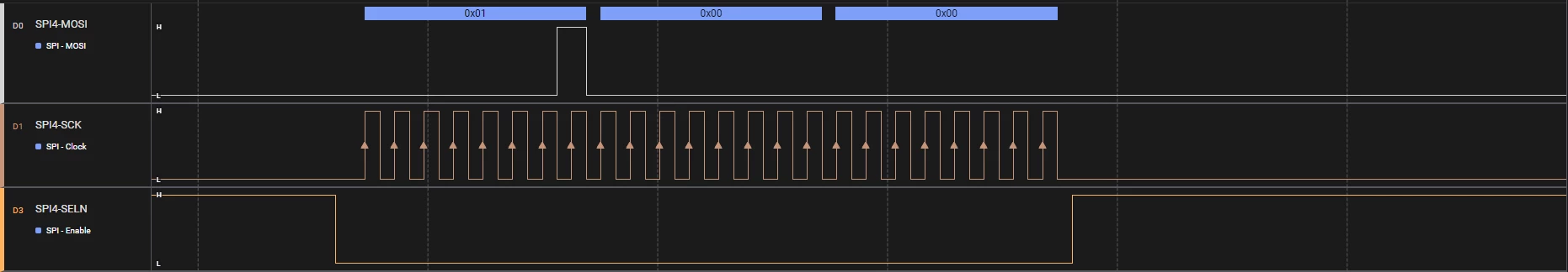

Hello all,
I am currently working on a project with the STM32H743VIHX and I have been having some issues getting SPI communication with an external DAC working. The test I have built is supposed to transmit 24bits of data to the external DAC and record the output on one of the STM32's ADC's. I have a code snippet below but the full project is zipped for further detail:

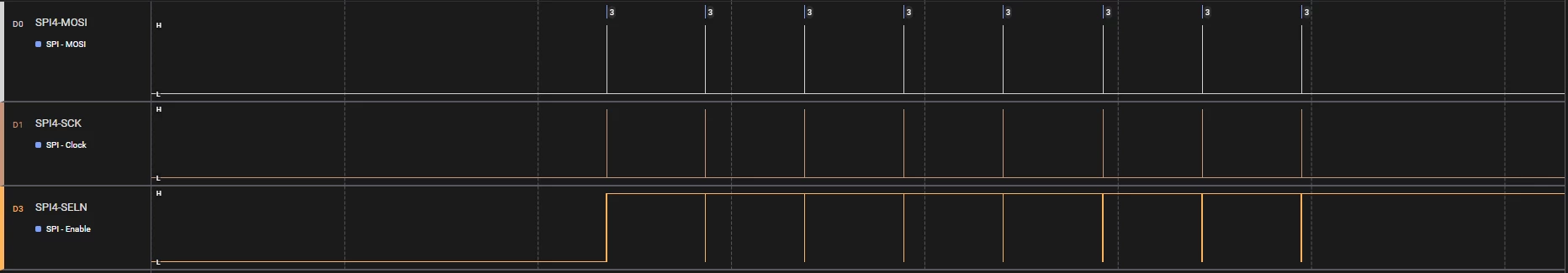

When I run this firmware on my board I get the following output on my logic analyzer:
Zooming into the first transmission I see that following :
0693W00000aJZUOQA4.pngThe data seems to be sent as expected. What is strange is the multiple transmissions shown in the first screen capture. If I zoom into the second transmission I get the following:

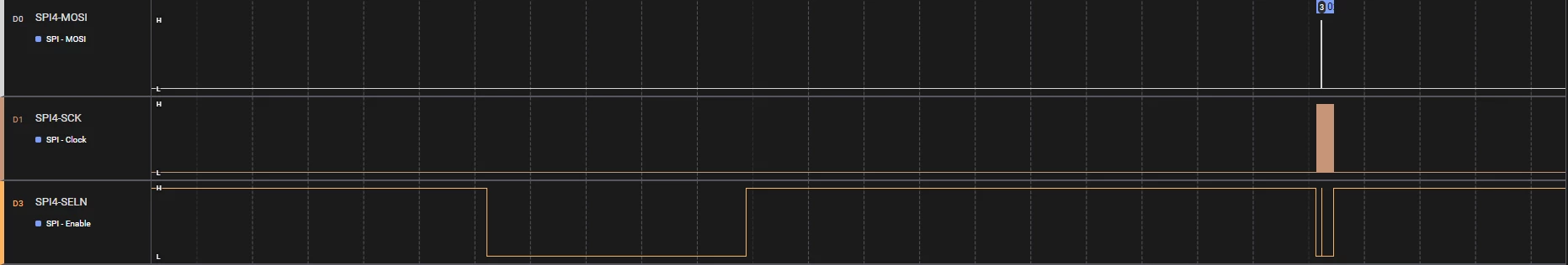

0693W00000aJZUwQAO.pngThe select line seems to drop out and then the select line is pulled high again part way through the second transmission. I have attached the .sal file from the logic analyzer as well as a csv file containing all of the data below as well in SPI_Transmit_Issue.zip
My current theory is that the processor is resetting for some reason. When I add a break point to the on the HAL_SPI_Transmit_IT function It is reached multiple times even though main should get trapped in the while loop performing ADC captures.
I would appreciate any thoughts anyone has. Please feel free to ask any clarifying questions.

I ended up figuring out the Issue. IWDG1 is activated by default when generating the Hal files, disabling it fixed my issue.
