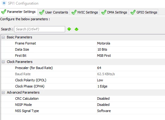

    Hi Hashem
    I am having problems too, all though I dont have a full understanding of it.
    But I would imagine how it works is as follows:
    https://developer.mbed.org/users/EricLew/code/STM32L4xx_HAL_Driver/docs/tip/group__SPI__Exported__Functions__Group2.html#ga02ec86e05d0702387c221f90b6f041a2
    (SPI_HandleTypeDef *hspi, uint8_t *pData, uint16_t Size, uint32_t Timeout)
    When you use
    , the clock pin outputs based on the size of the data (hspi1.Init.DataSize) and the
     multiplier parameter (which is the third parameter,
    uint16_t Size
    If your hspi1.Init.DataSize is set to 10bit, and the multiplier is set to 1, then the clock pin will output 10 times.
    If the multiplier is set to 2, then the clock pin will output 20 times
    However the
     parameter (
    uint8_t *pData) will only transmit on the first 10 bits.
    Here I am sending 0xF, 10bit data size, 2 x multiplier
    based on the datasheet of the device i am talking to, I cannot use 2 x multiplier. Why? because it will send data during
    . And to my understanding,
     is non blocking mode, which means the application waits for
     to finish before proceeding with the rest of the program/application.
    So I would image I would use
     with a multiplier of 1, where the clock sends 10 bits.
    Then I would use
    https://developer.mbed.org/users/EricLew/code/STM32L4xx_HAL_Driver/docs/tip/group__SPI__Exported__Functions__Group2.html#gafdf43dbe4e5ef225bed6650b6e8c6313
     with also a multiplier of 1, causing the clock to sen additional 10bits and also listening on the MISO line.
    But what actually happens when you use

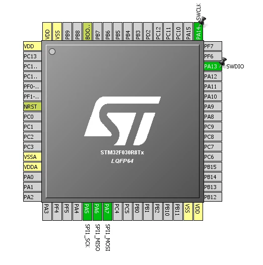

    , it does not send any additional bits on the clock (otherwise i would see it on the oscilloscope) and instead goes to some sort of infinite loop called HardFault_Handler0690X00000607LFQAY.png
    Why? this is the third device in a row I have used that has the exact same problem with SPI under the STM32 family.
    the varibles I am using:
    uint8_t SpiTransmit = 0xF;
    uint8_t SpiReceive;
    calling the HAL functions in main while(1)
    HAL_SPI_Transmit(&hspi1, &SpiTransmit, 1, 10);
    HAL_SPI_Receive(&hspi1, &SpiReceive, 1, 10);
    HAL_Delay(100);
    initiation code generated from STM32CubeMX 4.19

    S.Ma
    Principal
    Jul 2, 2017 2:13 PM UTC
    Posted on July 02, 2017 at 16:13
    When using spi in bidir mode, the spi clock generation comes from sending out data. Some spi may have rx an tx fifo up to 32 bit chunck capacity. First is to properly write de SPI.DR in 8 or 16 bit mode which will be fifoed. Then the properly configured RXNE will tell when chunk has been received and ready for reading.
    There should be some details in the right STM32 Reference Manual.

    I changed
    hspi1.Init.DataSize to 8bit, and I am now getting the
    /external-link.jspa?url=https%3A%2F%2Fdeveloper.mbed.org%2Fusers%2FEricLew%2Fcode%2FSTM32L4xx_HAL_Driver%2Fdocs%2Ftip%2Fgroup__SPI__Exported__Functions__Group2.html%23gafdf43dbe4e5ef225bed6650b6e8c6313
    to send the clock signals, but only 16 in total instead of
    The only problem is, the data that will be sent down the MISO line will be 10 bit.
    It seems
    cannot pass on anything more then 8 bit.
    So I added another line
    and got another 8 bit clock signals.
    Which means if I have two different variables i can then work out the 10bit communicationreceived.
    So for anyone one else out there trying to work this out, only use 8bit parameter for
    hspi1.Init.DataSize
    Thank you KIC8462852 EPIC204278916 for your assistance.
