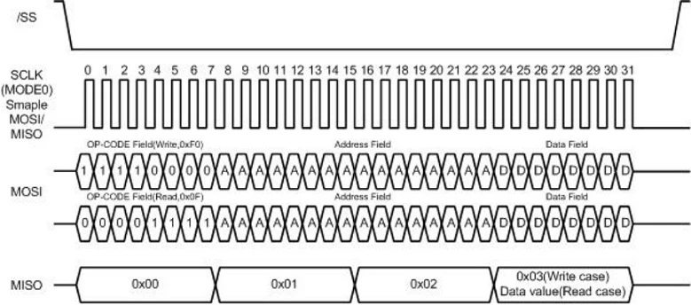

Hello
I want to set some parameters on W5100 chip and then read them. the parameters sets right, but when I want to read a register what I receive from SPI is value of past register address I've sent. My micro is STM32F103 and I use KEIL here is my codes, I use these functions too write and read SPI:
void W5100_write(u16 addr, u8 data)
//SPI_NSSInternalSoftwareConfig(SPI1, RESET); // enable the W5100 chip
GPIO_ResetBits(GPIOA, GPIO_Pin_4);
while (SPI_I2S_GetFlagStatus(SPI1, SPI_I2S_FLAG_TXE) == RESET);
SPI_I2S_SendData(SPI1, W5100_WRITE_OPCODE); // need to write a byte
SPI_I2S_SendData(SPI1, (addr & 0xff00) >> 8); // send MSB of addr
SPI_I2S_SendData(SPI1, (addr & 0xff)); // send LSB
SPI_I2S_SendData(SPI1, data); // send the data
//SPI_NSSInternalSoftwareConfig(SPI1, SET); // disable the W5100 chip // done with the chip
while( SPI1->SR & SPI_I2S_FLAG_BSY );
GPIO_SetBits(GPIOA, GPIO_Pin_4);
u8 W5100_read(u16 addr)
u8 data;
SPI_I2S_SendData(SPI1, W5100_READ_OPCODE); // need to write a byte
SPI_I2S_SendData(SPI1, (0x00)); // send Dummy byte
while (SPI_I2S_GetFlagStatus(SPI1, SPI_I2S_FLAG_RXNE) == RESET);
data = SPI_I2S_ReceiveData(SPI1); // done with the chip
return data;
here I write then read and send to pc by usart:
W5100_write(W5100_GAR + 0, pcfg->gtw_addr[0]); // set up the gateway address
W5100_write(W5100_GAR + 1, pcfg->gtw_addr[1]);
W5100_write(W5100_GAR + 2, pcfg->gtw_addr[2]);
W5100_write(W5100_GAR + 3, pcfg->gtw_addr[3]);
delay_ms(1);
while( !(USART1->SR & 0x00000040));
USART_SendData(USART1, W5100_read(W5100_SIPR + 0));
USART_SendData(USART1, W5100_read(W5100_SIPR + 1));
USART_SendData(USART1, W5100_read(W5100_SIPR + 2));
USART_SendData(USART1, W5100_read(W5100_SIPR + 3));
I can't understand whats the problem, thank you. #spi #w5100 #stm32f103 #spi

SPI is inherently bi-directional.  After every transmit the SPI also clocks in a data byte, which you have to clear with a dummy read.  Chances are you are overrunning the SPI RX buffer.

thank you for your response, I have done it by a DUMMY read.
in datasheet said that after sending address, the value of that comes on SPI, and I send a 0x00 byte too read the Value, but its value of previous address I sent in previous session!
_behn4m
_behn4mAuthor
December 25, 2013
Posted on December 25, 2013 at 15:51
thank you a lot for you'r attention
that's what exacly happening: I write on 4 addresses, and then I want too read them to make sure that I'm doing right. I read 4 addresses with read function, but at every SPI session, my received data is value of previous session address!
In data sheet said do what I'm doing with my read and write functions! here is the SPI signallimg diagram in datasheet:0690X00000602kaQAA.jpg

lowpowermcu
December 25, 2013
Posted on December 25, 2013 at 19:30
Hi Beh,
Can you give us the value of status register ''SPI_SR'' when you exit
W5100_read()
I am suspecting an overrun condition...
_behn4m
_behn4mAuthor
December 25, 2013
Posted on December 25, 2013 at 20:02
it is 0x43!
lowpowermcu
December 25, 2013
Posted on December 25, 2013 at 20:17
Hi Beh,
As you are using SPI in Full Duplex you must read data every times you write in data register (even if you do not need it). The writing sequence should be something like the code below:

_behn4m
_behn4mAuthor
December 25, 2013
Posted on December 25, 2013 at 20:48
thank you, very good point
I was testing this when I saw your answer. I found the override is happening and it's needed too read DR after each send. so nice, I've used dummy variable in my test, as you :D
my problem SOLVED, Thanks a lot
