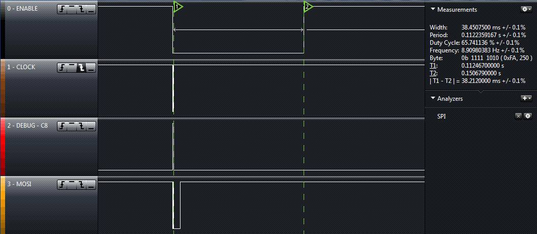

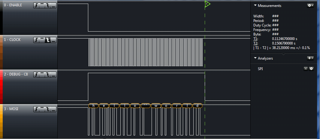

I managed to get NSS working with DMAon a STM32F0 MCU, and have
/public/STe2ecommunities/mcu/Lists/cortex_mx_stm32/Attachments/28510/spitransfer.zip
needed to accomplish that.
The very, very weird thing I encounter is that the NSS pulse is going high 30ms AFTER the SPI1 has been disabled in the DMA routine. You can take a look at the code, I lower pin C8 after disabling the SPI (which happens 4.7µs after the last CLK flank), but it takes another 38 ms before the NSS rises again! In the reference manual (RM0091) it is stated that the NSS will rise after the SPI is disabled, so where do I get this delay?
View of data, and PC8 dropping after transmission, and after SPI1 is disabled. Transmission takes 235µs:
View of complete transmission (on this scale only a white bar on CLOCK), with NSS pin going high ~38ms after the SPI1 is disabled. WHY?
ST, please write a decent application note with examples of SPI and DMA usage, and verify the output. I previously worked with Atmel XMEGA, please take a look at their documentation as an example.
Why is the NSS pin lagging so much?
