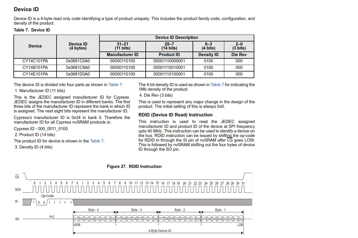

i am expecting reply 0x0681c8a0 but i am getting 0x000681c8 and when read 5 byte got
 0x000681c8a0 .so receiving one extra byte at beginning. after searching some time on net i found that its due to dummy receive while transmitting.so i try to flush rxfifo after tx.but when i try flush instruction random data received every time so please guide me whats wrong
here is command information
  i use pb12 as gpio out put which is connected to ss of external ic and data size is 8 bit .

    Remember that SPI is always bidirectional, even if you don't want the data you have to do something with it.  When you send a command string you have to read back the data shifted in while shifting out each byte of the command.
    Whenever you start an SPI bus operation make sure the receive buffer is empty before shifting out the first byte.  Always clear the receiver before shifting out the next command byte.
    If you use DMA this can be done automatically by setting up both rx and tx DMA channels.  When sending data the receive channel always goes to the same location, no memory increment, so the data is thrown away.  When receiving data the transmit DMA channel always shifts out from the same location, since you only need a dummy output to generate a clock.  And if you use DMA, make sure RX always has a higher DMA priority than TX so the receiver will stay cleared.
    Some SPI peripherals require a ''dummy'' byte in order to process the command internally before shifting in/out data.  The part datasheet should show if you need to allow for this.

    thanks for reply.last byte is not missed what happen is,
    first i send 1 byte read command so 1 garbage byte is received in fifo
    then i write flush rxfifo instruction
    now i use hal_spi_receive api with data size 4.so it call txrx function.and as datasize>1.it select 16 bit allignment.and as there is already one byte in fifo(garbage)+one original byte received so rxne is raised and one word is read out with 1byte garbage.now tx and rx count is decremented by 2.now furter 2 byte transmitted and received in fifo.but due to allinment rxne is generated before 1 byte prior.so final byte is received in fifo but not red out by api.so here my problem is flush fifo api not working
