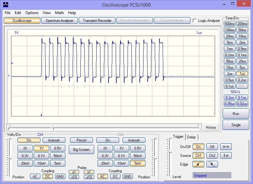

Hi.
So I'm having a peculiar problem with the SPI on the STM32F072.
I'm trying to configure SPI1 and it seems to work, but with one cave-eat. I can't seem to configure the bit size (SCLK) down to 8b from 16b. I've been trying to do it through the CMSIS initialization structure but the changes aren't having any effect, so I've also tried it directly in the configuration registers. Still no luck.
The part where I tried configuring the registers manually:
SPI1->CR2 &= ~(1<<11);
SPI1->CR2 |= 0x700;
SPI1->I2SCFGR &= ~(1<<10);
SPI1->I2SCFGR &= ~(1<<11);
As you can see I've also thought about having the SPI configured in the I2S mode, but this doesn't seem to be the case.
The inserted picture is the oscillograph of the SPI Clock line (single transfer). No matter what I do, it clocks 16 bits.
The initialization routine is below:
SPI_Cmd(SPI1, DISABLE);
SPI_InitStructure.SPI_BaudRatePrescaler = SPI_BaudRatePrescaler_4;
SPI_InitStructure.SPI_CPHA = SPI_CPHA_1Edge;
SPI_InitStructure.SPI_CPOL = SPI_CPOL_Low;
SPI_InitStructure.SPI_DataSize = SPI_DataSize_8b;
SPI_InitStructure.SPI_Direction = SPI_Direction_2Lines_FullDuplex;
SPI_InitStructure.SPI_FirstBit = SPI_FirstBit_MSB;
SPI_InitStructure.SPI_Mode = SPI_Mode_Master;
SPI_InitStructure.SPI_NSS = SPI_NSS_Soft | SPI_NSSInternalSoft_Set;
SPI_Init(SPI1, &SPI_InitStructure);
SPI1->CR2 &= ~(1<<11); //
SPI1->CR2 |= 0x700; // Set databyte size number to 0111
SPI1->I2SCFGR &= ~(1<<10); // Choose SPI mode
SPI1->I2SCFGR &= ~(1<<11); // Disable I2S Peripheral
SPI_Cmd(SPI1, ENABLE);
I'd be very grateful for any help or ideas.

And what are the content of CR2 and I2SCFGR before you enable the SPI peripheral?

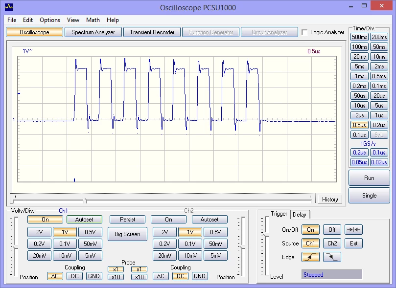

So just for kicks, I initialized the structure with
SPI_InitStructure.SPI_DataSize = SPI_DataSize_4b;
And this is the result (SPI clock)
The value of the CR2 register is properly initialized for the 4-bit transfer, but from the oscillograph, we can see that there are 8 clock cycles there.
Now I'm really interested in what exactly is happening. Did I completely misunderstood SPI, or is there something fishy going on?
Tesla DeLorean
Guru
June 24, 2015
Posted on June 24, 2015 at 17:32
Well there's really no point starting a new thread if you're just following on from the original narrative.
May be it's how you're sending the data?
This is really hard to know here remotely as your code snippet really doesn't provide adequate context to see both how you're configuring, and how you're sending. Please provide a complete/concise example that configures the clock, pins and peripherals, and sends the test data.
