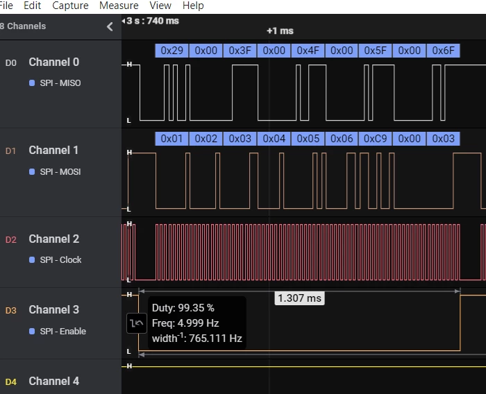

SPI Overrun error is occurring in stm32g030kt6 MCU Slave
  • September 7, 2023
  • 1413 views
I programmed stm32G030kt6 controller as slave .it need to send requesting packets to master . what is happening is  alternative packet is  getting skipped from my buffer as shown in below image .
uint8_t tx_buffer[41] = "\x29"
"\x3F\x4F\x5F\x6F\xFF\xFF\xFF\xFF\xFF\xFF"
"\xFF\xFF\xFF\xFF\xFF\xFF\xFF\xFF\xFF\xFF"
"\xFF\xFF\xFF\xFF\xFF\xFF\xFF\xFF\xFF\xFF";
kindly help in solving this. i can provide more information on this if it is needed
Best answer by Nchun.1
Thank you issue is solved now . typecasting the SPI data register is incorrect

Nchun.1
Nchun.1AuthorBest answer
September 7, 2023
