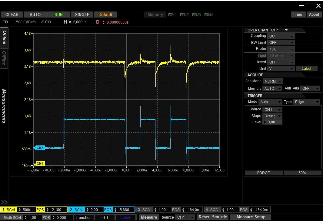

SPI on STM32F411RE doesn't work and the Clock is not running correct
I'm trying to connect my MPU6500 to my Nucleo f411re board with the SPI Protocol.
The MPU6500 is working correctly because I tested it with an Arduino and it worked as expected.
I'm using SPI2 with the Pins PB15, PB14 and PB13.
But for some reason I can't get it to work on the STMF411. Infact the clock isn't even working correctly as you can see on the oscilloscope.
Yellow is the Clock and Blue is MOSI. (Yellow is scaled to 500mv and Blue to 5v)
Maybe my configuration is wrong?
I hope someone could help me it and spot the mistake.
Thanks in advance!

TDKBest answer
Jun 20, 2020 2:21 AM UTC
RXNE gets set every time a byte comes in. For SPI, this happens every time you send a byte. For single byte transfers, you should:
  1. wait for TXE
  2. Set SPIx->DR = x
  3. Wait for RXNE
  4. Read SPIx->DR to clear RXNE
You're not doing this on every byte transfer.

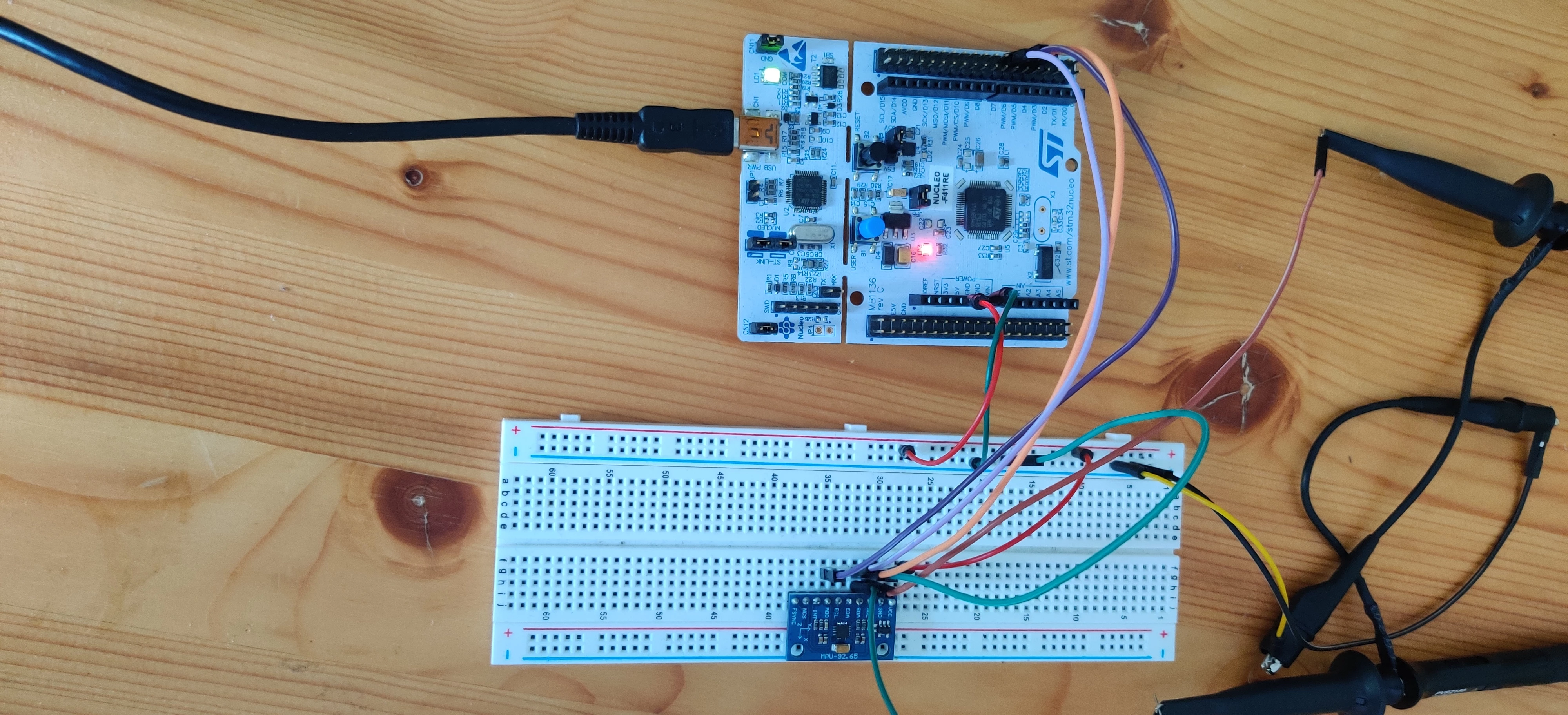

TRudn.1
TRudn.1Author
Jun 19, 2020 11:47 AM UTC
If I just set the connected Pins to Output and toggle them manually everything works as expected.
Furthermore the following code works fine as well.
I also included a picture of the wiring. I Just connected the MPU6500 to the board nothing else.0693W000001r548QAA.jpg

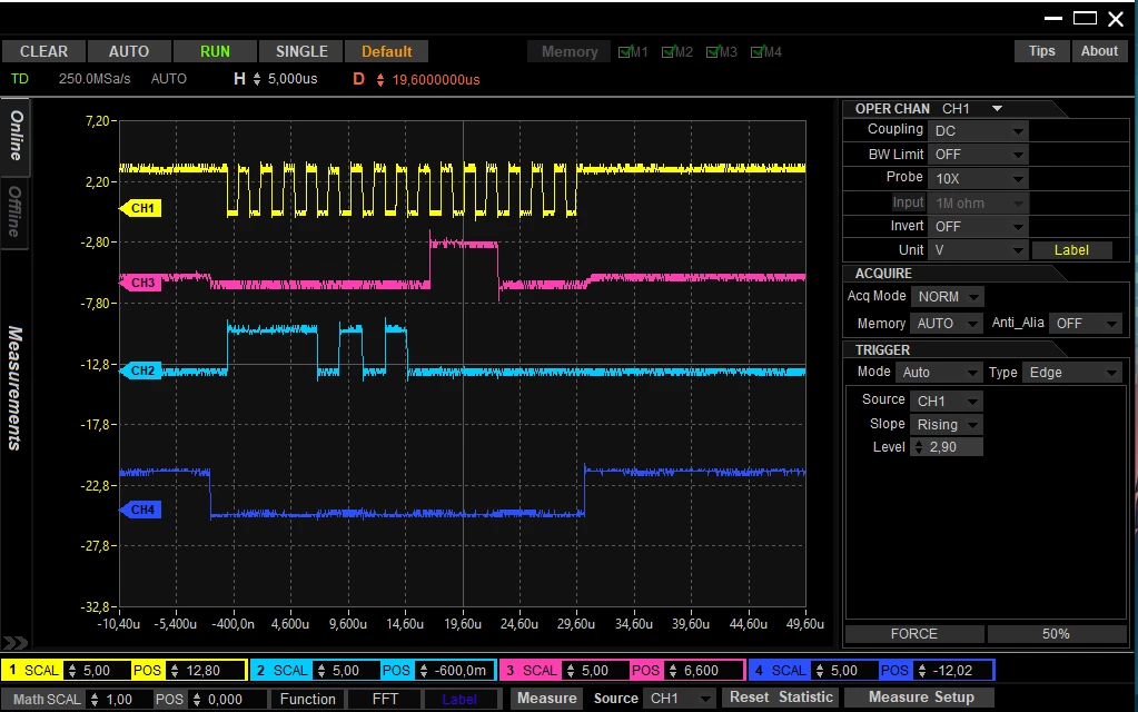

Jun 19, 2020 8:51 PM UTC
Ok after adding toggling and adding the CS Pin the MISO line works as well and also the data which is transmitted seems to be correct. The MPU6500 should send 0x70 and on the oscilloscope it looks like this value. Nevertheless am I still receiving just 0 and I'm not sure if I configured the MISO Pin correctly or if the reading function is wrong.... Due to my mistakes I post the current code version here again. Thanks again for all your help!
Yellow: Clock, Dark Blue: CS Pin, Light Blue: MOSI, Pink: MISO

TDKBest answer
  1. wait for TXE
  2. Set SPIx->DR = x
  3. Wait for RXNE
TRudn.1
TRudn.1Author
Jun 20, 2020 7:51 AM UTC
Yes again another mistake.... I assumed the SPIx->DR Register would be overridden.
The new Code works without a problem. Thank you guys very much. Since I'm very new to this low level type of programming without any HAL oder Arduino libraries this code still might not be efficient enough or any bad practice styles. If so I would be happy if you let me know :)
