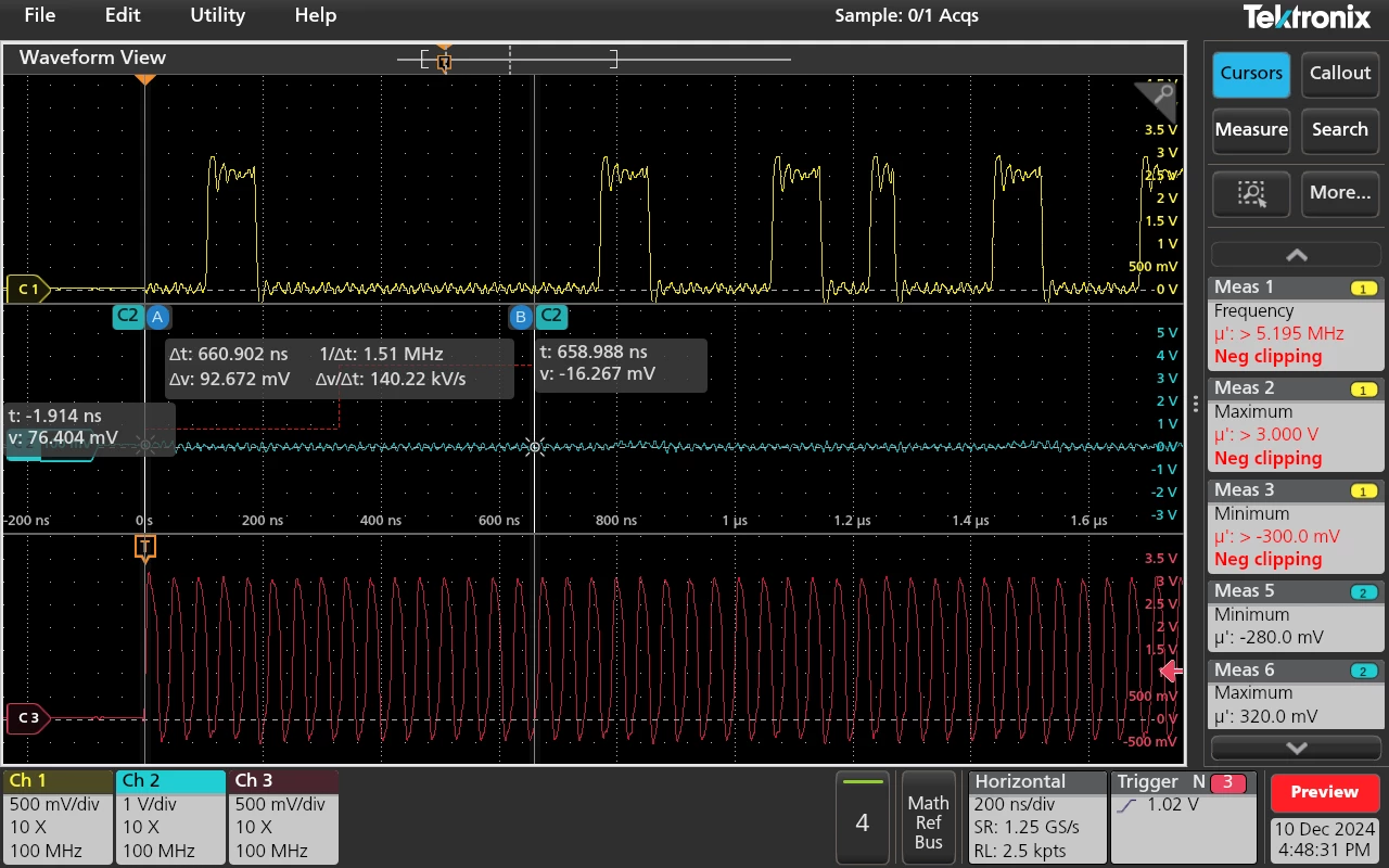

I am using an STM32F767ZI MCU on a custom PCB. I am trying to Implement an SPI interface to an DAC Chip (AD5443) through DMA (no interrupts as of the moment). My DMA is configured as a circular buffer.
One requirement from the DAC is that after one data frame, the CS (NSS) must go high for a minimum of 30 ns to drive the output current. However, the issue I face is that the NSS signal never goes high in between data frames. To address this, I set Bit 3 on SPI2_CR2 to enable NSS Pulse, which is supposed to create a pulse on NSS in between two frames (I checked the timing, one pulse should equate to 40 ns). But the NSS pin remains low throughout. Can someone explain to me what I am doing wrong?
Currently, I have configured the following SPI registers as such:
SPI2_CR1: 0x0044
SPI2_CR2: 0x0F0E
It seems that most of configuration is correct, as I see that the MOSI and CLK signals are correct. However, my NSS pin never goes back high.
Here are the relevant signals.
Ch1 Yellow - MOSI
Ch2 Blue - CS
Ch3 Red - SCLK (cursors are aligned to show one data frame of 16 bits)
Note: I've confirmed that the data being sent over is not an issue, as manually sending data over SPI (without DMA) works fine and drives the output. I've also manually toggled the NSS pin to confirm that the connection is not an issue.

waclawek.jan
waclawek.janBest answer
Dec 11, 2024 9:00 AM UTC
	SPI2->CR2 |= (2u << 1);					// Set SSOE to enable Slave Select Output
	SPI2->CR2 |= (15u << 8);				// Set bits 11-8 to indicate that I am performing 16bit data transfers
	SPI2->CR2 |= (3u << 1);					// Enable NSS Pulse Management to generate a pulse between two consecutive data cycles (THIS IS NEEDED to allow the CS pin to go back high in between data transfers)
You probably meant (1<<2) to set SSOE and (1<<3) to enable NSSP.
To avoid such blunders, don't use "magic numbers" but symbols from the CMSIS-mandated device header, also don't perform several RMW operations on the registers, rather calculate a value and write it once (see e.g. end of this writeup).
