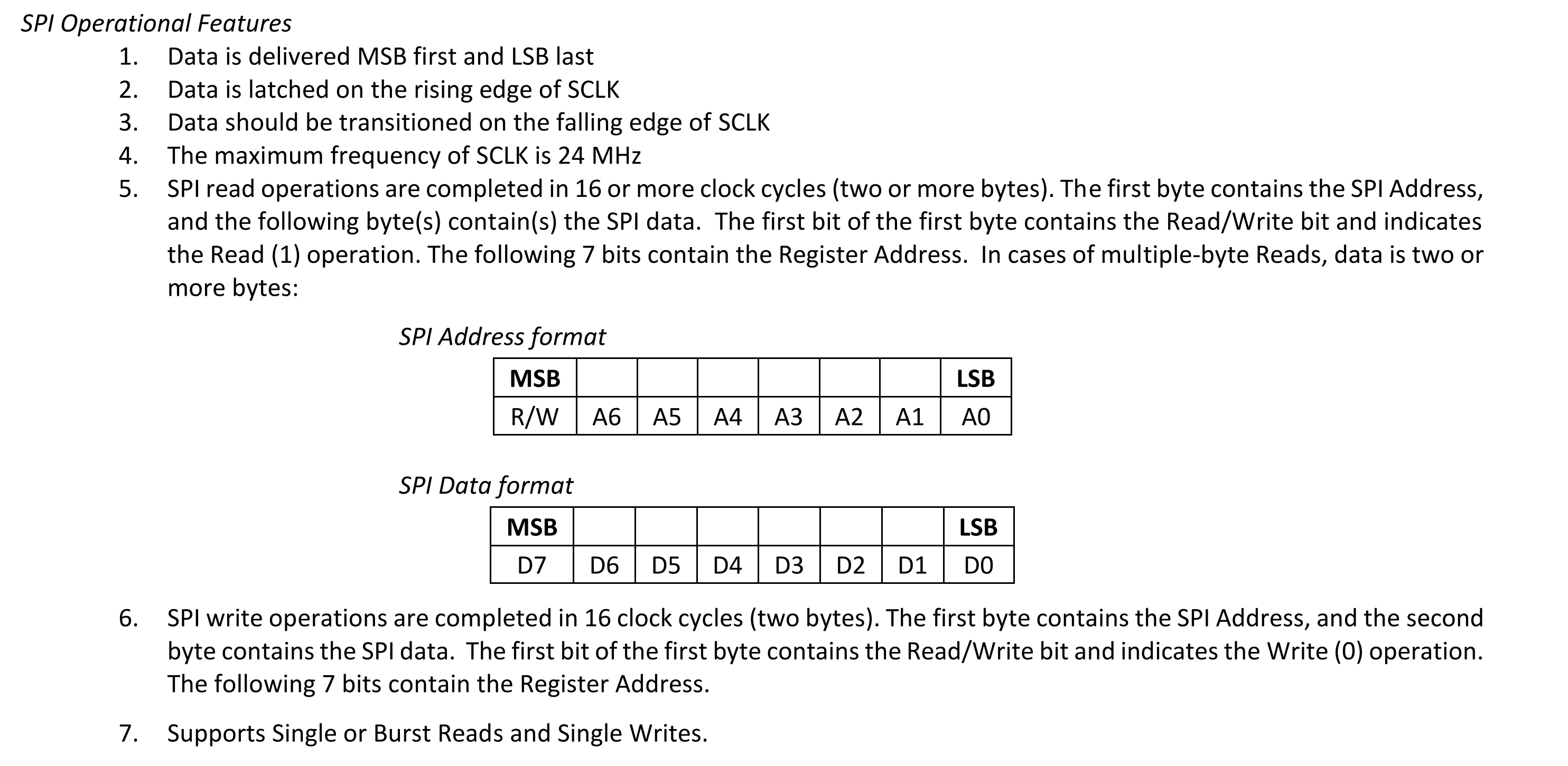

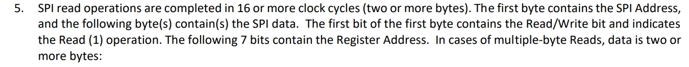

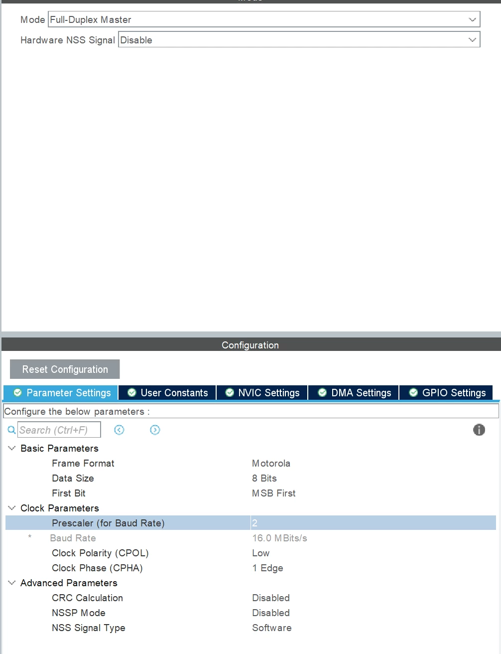

I'm trying to communicate with a slave device (ICM-42688-P: https://invensense.tdk.com/wp-content/uploads/2020/04/ds-000347_icm-42688-p-datasheet.pdf), but I don't recieve anything on the MISO line. I'm using the nucleo-wb55rg for the master device. The ICM-42688 typically needs 1.8V for the VDD and VDDIO, but the datasheet says it can be used between the range of 1.71V and 3.6V. Therefore I just used the nucleo's 3.3V pin output to power both. After that I configured the SPI following the datasheet:
The code I wrote for excercise is a read from the whoAmI register, which is at address 0x75 and contains the value of 0x47. However I only get 0s from the MISO line.

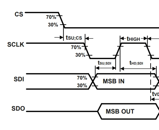

Andrew Neil
Apr 15, 2024 3:23 PM UTC
The datasheet doesn't suggest any need for delays:

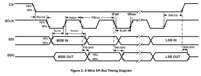

(after 30 mins on ds ...)
1. spi clk mode is wrong:
set : cpol hi + cpha 2edge (as i see from this timing diagram)
+ set in Cube/ioc :
2. command / response
I would use :
/*HAL_SPI_TransmitReceive(SPI_HandleTypeDef *hspi, const uint8_t *pTxData, uint8_t *pRxData,
 uint16_t Size, uint32_t Timeout) */
uint8_t TxData[16], RxData[16];
so:
TxData[0] = 0x91 ; // read : whoami
HAL_SPI_TransmitReceive(&hspi1, TxData, RxData, 2 , 50);
The response should be in Rxdata[1] then.
3. set spi clk to 1 MHz or so, faster is no problem - if it works fine.
Apr 17, 2024 10:52 AM UTC
I tried out your suggestion and it worked (on both cpol low & cpha 1 and cpol high & cpha 2). Now I can see data on the MISO line on the oscilloscope and the debugger. However I read on the MISO line 0x40 in spite of the WhoAmI register should contain 0x47. Do you have and idea where that 0x07 goes?
