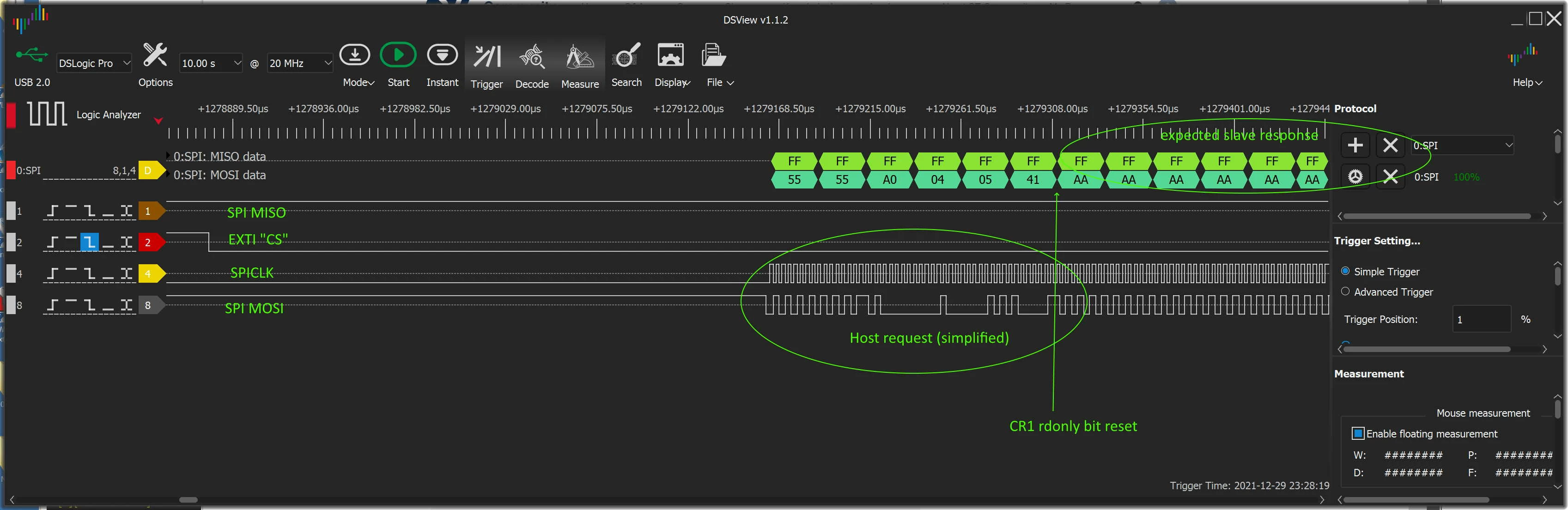

In order to analyze the incoming SPI frames i setup the STM32F103 to use interrupts for receiving and start communication in "SPI_Direction_2Lines_RxOnly" Mode (i.e. Bit 10 rxonly is 1). The slaves shall send their response only when addressed (i.e: address matches) and i wanted to use TXDMA (DMA1Channel5). For this reason all slaves have their DMA setup accordingly and whichever of them is addressed starts transmission after the command block was received with the matching address.
So after the command block of 8 bytes the RX ISR switches off Bit 10 and I thought this would trigger transmission but it does not.
I also tried to disable SPI - reset bit - enable SPI again, do a full reinit, reinit DMA ... nothing helped.
In the RM0008 on page 743 it is mentioned that this bit is intended to be used in multislave applications but what am i doing wrong here ? SPI2 is functional and bytes are received as intended only the slave transmission hesitates to start. Which "kick" is necessary to start transmission ?

edit: so the problem was the DMA configuration in my case (Peripherial address). In the RXInterrupt after knowing that the address matches:
            SPI_Cmd( SPI2, DISABLE );
            SPI2->CR1 &= ~SPI_Direction_2Lines_RxOnly;
            DMA_Cmd( SPI2_XMIT_DMA, ENABLE );
            SPI2->CR2 |= 0x0002; // SPI_I2S_DMACmd( SPI2, SPI_I2S_DMAReq_Tx, ENABLE );
            SPI_Cmd( SPI2, ENABLE );
the RDONLY bit is reset and the slave starts responding at the next character.

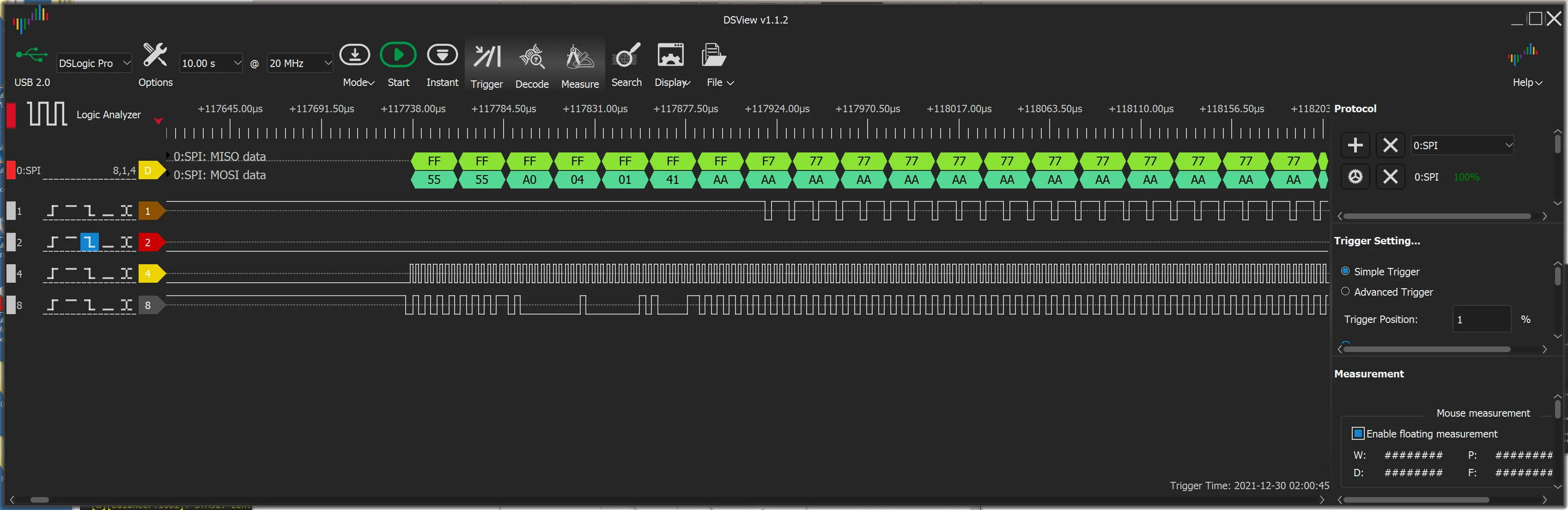

I made a little progress when writing 0x77 to the DR register so the problem seems to exist with linking/triggering the DMA ?
0693W00000Hq7ucQAB.jpgI thought this would be enough besides initializing the appropriate DMA channel.
But whatever is written to the DR register manually stays there and no DMA fetch takes place hence the DMA TC int is not fired either.

The DMA always reads 00 and DMA TC interrupt never occurs. According to the reference manual SPI2 TX DMA should be DMA1 channel 5.
So proceeding a little and at least the SPI slave is now responding ;)
Thank you !
