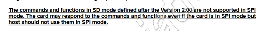

I have  a very basic question. In the spec of the U5 series there is this:
Does that really mean that the U5 would not support talking to an SD card in SPI mode? I find it hard to believe since SPI seems to be the most basic way to interface with an SD card.

I guess they wanted to say that the SPI mode is not supported through the SDMMC block.
You have to use a dedicated SPI block instead.

I think this makes the most sense. The Simplified specs v6 states:
I'm guessing it's simply restating this, since in the older L4 series we have:
Anyways, it's not so much important I just found the sentence curious. I believe SPI mode can still be useful in some applications where we don't have access to numerous pins.
