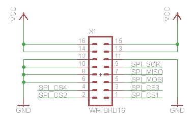

I have a Nucleo-F439ZI as SPI master connected to four Nucleo-F030R8 SPI slaves.
Initially, the SPI communication was working perfectly fine. But after a while, the master received only zeros on MISO line even though, the slaves where sending data != 0 (verified by logic analyzer).
I first suspected a bug in my code, wrong SPI configuration, wiring issues and so on. But soon I recognized, the SPI1_DR always reads zero, even when the MISO pin (PA6) is tied to 3.3V! The port config looks fine (Alternate function 5, PP, no pull devices). Also SCLK and MOSI are working perfectly fine.
So, I assumed a broken MCU, replaced the master Nucleo board by another new one and everything was working fine again. I ran a test, sending/receiving more than 100,000,000 SPI frames successfully without a single error (verified by SW CRC check on protocol layer).
One day later, I powered the setup again without any change to HW or SW and now, the second board/MCU was broken. Same issue, SPI_DR reads only 0, no matter what the actual input is. I tried a third Nucleo board and it was working fine again.
I checked the GPIOA_IDR.IDR6 and it perfectly reflects the logic level applied to the pin, so, it's not a broken port input. I also tried to use another port pin as MISO input (PB4 [AF5]), but still the same. Looks like the input path is broken somewhere after the port multiplexer.
Since the original SW is quite complex, using HAL, SPI with DMA and complex logic, I created a small test project configuring the GPIOs and SPI manually and just sending/receiving SPI data in a while-loop with polling the SPI1_SR.RXNE flag. Same behavior here: working well on a new Nucleo board, not receiving any data on the first two "broken" boards.
Also I could not find any errata that would explain this behavior.
I have to mention, that I use a ~45cm ribbon cable to connect the SPI master to the slaves, which I know is not really state-of-the-art. However, the signals look well on oscilloscope and logic analyzer. The layout of the ribbon cable is: CS-GND-MOSI-GND-MISO-GND-SCLK-GND.

The board is powered by a stable laboratory power supply with 8V on VIN (JP1 = OFF, JP3 = 5-6).

_Daniel_Author
September 24, 2024
@PGump.1 , thanks a lot for your comments. I am keeping Latch-Up in mind.
Actually, the pure ESD theory make less and less sense... the max. measured voltage at MISO pin (~3.7V) is always way below the maximum value for five-volt tolerant port pins (VDD + 4V).
Also, it looks like the internal protection diodes of the port pin are still working properly: I connected power supply with 3mA current limit to the MISO pin of a damaged board and slowly increased / decreased the voltage above/below the max./min. voltage ratings. When coming close to the limits (6.8V for max. / -0.2V for min.), the current slowly increases => internal diodes get conductive!?
If an ESD would have damaged the MISO input, shouldn't it then also have damaged the diodes?
Regarding Latch-Up I found the following recommendations:
  • Power on sequence => for SPI, as well master as slave has inputs, so I could not imagine a meaningful power-on sequence...
  • Changing the connection setup would be the very last option, not easy to achieve
  • Adding series resistors to the data signals to limit the current => that's an option
  • Adding supressor diodes => also an option but most probably not effective during power ramp up
  • Adding series resistors to the power supply lines => maybe an option but unnecessary power dissipation
Something that might be worth to mention with respect to power on sequence: Since the Nucleo board is missing the external crystal (X3) and is instead clocked from the MCO of the embedded ST-Link, I had an iussue, that the MCO clock comes very late (~2s) after power-on when no USB cable is connected to the ST-Link. So, I increased the HSE Startup Timeout to 3000ms. During this time, the SPI lines might be floating and the SPI cell not yet clocked / powered...
Each of these 5 boards have their own VCC. How do you keep the VCCs in-sync?
Kind regards
Pedro
AI = Artificial Intelligence, NI = No Intelligence, RI = Real Intelligence.
_Daniel_Author
September 24, 2024
Hmm....All boards are supplied from the same V_IN via ribbon cable (the same, that also carries the SPI data lines; 4 wires in parallel for bigger cross section). The VCCs are generated separately by the onboard voltage regulators and not necessarily 100% in sync...
(VCC here is connected to V_IN of the Nucleo boards)

There is no additional circuitry on the SPI lines, 1:4 direct connection of SCLK, MOSI and MISO without termination. Only for the CS there is some logic gates to make the slave address configurable via DIP switch.

The answer is that the VCCs are NOT sync'ed. Using the laws of current flow, the boards will attempt equilibrium by pushing and pulling current through your IO lines. Unless you have made allowances for this in your design, this WILL put undue stress on the IO lines. Is it enough to over-stress - that is a matter of luck!!!
It is unfortunate that ST doesn't publish enough on this subject to allow for informed choices.
However, the subject is common to CMOS fabricators. You will find that sites like www.ti.com, www.nxp.com, and others are much more informative on the subject of Latch-up...

You want to prevent phantom powering your MCUs and prevent latch-up.
I have some ideas:
  1. Delay in master to wait before driving the SCLK, MOSI and CSN pins. This is not a guarantee as you don't know if and how long slaves take to power on, but it gives time for the VCC of the slaves to stabilize before sending anything. It won't help with powering off.
  2. Pullups on CSN on slaves. Prevents slaves from thinking they are selected before they are connected to master or before master.
  3. series resistors. Limits current. Can also help limit reflections and limit crosstalk.
  4. Enable brown out in your MCU. Powers off the MCU if VCC gets too low. This stops any pin from driving when you power everything off. Might help when powering everything off.
  5. external clamping diodes, often come in a package specifically designed for a particular interface (such as USB or I2C).
  6. true open drain interface. Puts limits on speed and requires additional circuitry.
  7. Switch to an interface designed to go off board such as RS485.

For now, I will create a new piggy-back PCB for the master evalboard, with series resistors, pull-downs, TVSs and the possibility to provide external 3V3 supply.I will let you know if it helped in 1-2 weeks :)
(this is just a prototype setup for a proof of concept; it would be sufficient, if it withstands for some months. The remaining comments will go into the final design)
