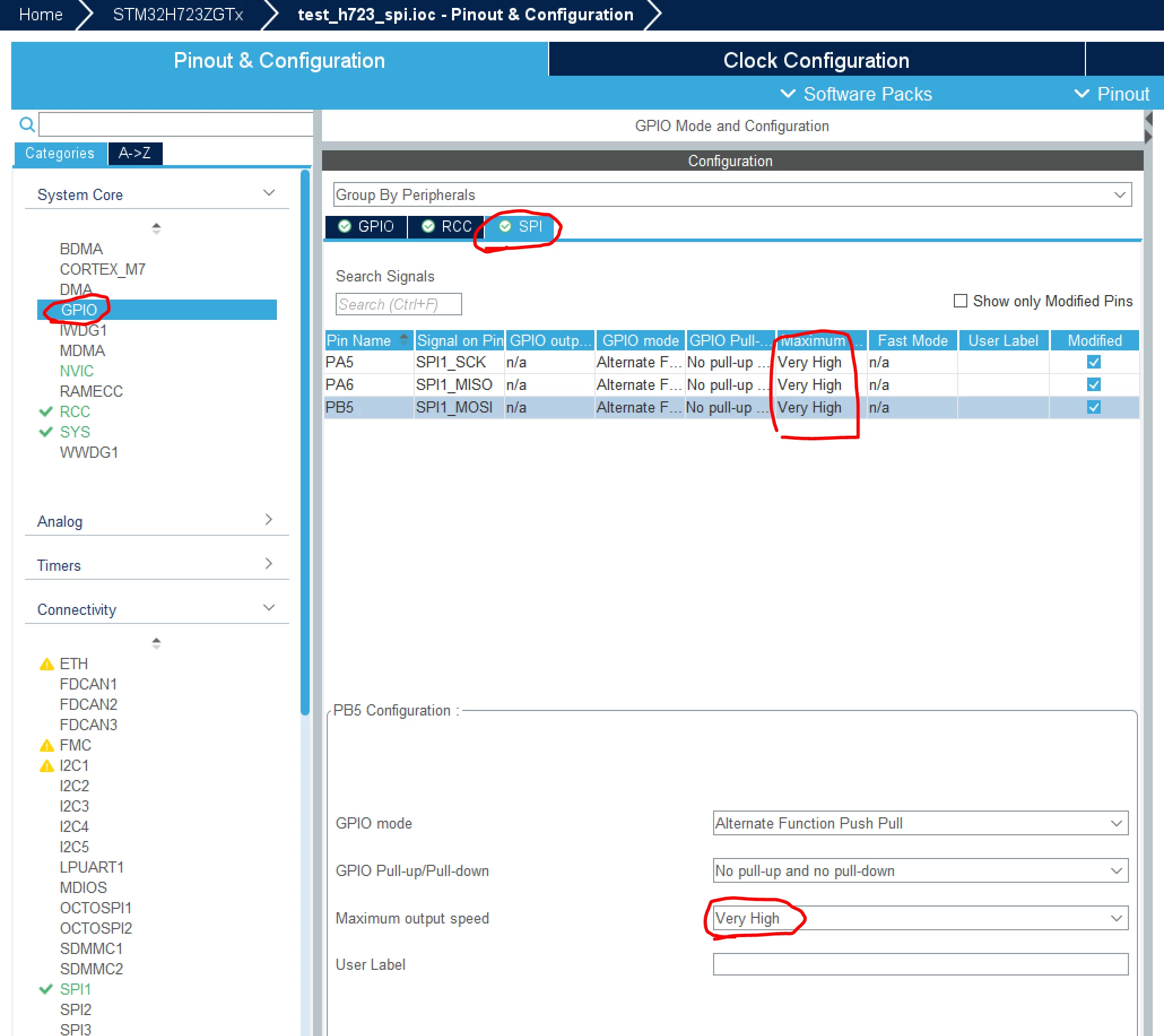

I ran this to ground.
Interestingly, the problem is that the pins are not initialized at the proper speed. They are at speed Low by default which clearly isn't enough for the fastest SPI speeds. Changing them to Very High fixes the problem.
You can modify the setting here:

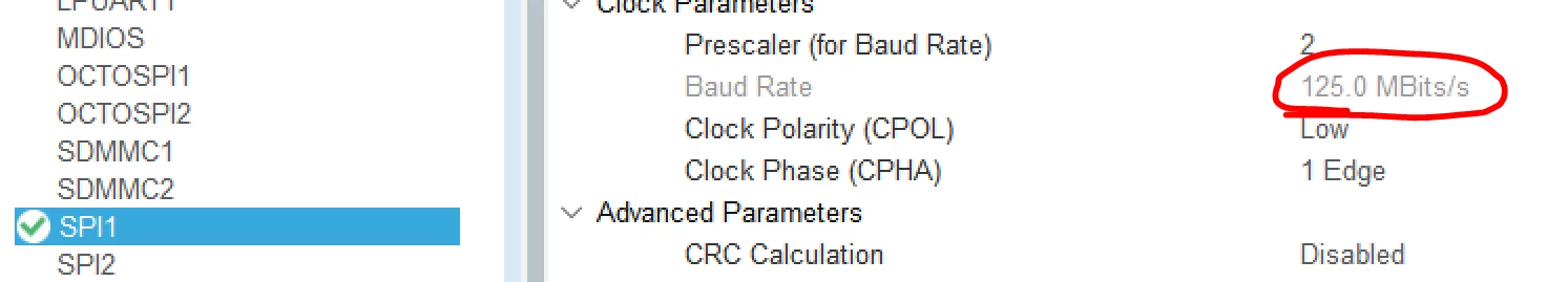

This isn't a HAL bug, but a CubeMX code generation bug. CubeMX knows the SPI data rate, so it should be setting these pins appropriately.
Also interestingly, for the F4 family, it sets SPI pins at Very High by default. So definitely an inconsistency at the least.
@Patrice LF @Amel NASRI can you look into? Not sure who to tag here.
(also just note that throwing a logic analyzer or scope on the line would have quickly showed the issue)

August 24, 2023
You're absolutely right, weird that it does not automatically choose a higher speed. Even setting to Medium worked fine for the speed I was looking for. Thank you for the response!
