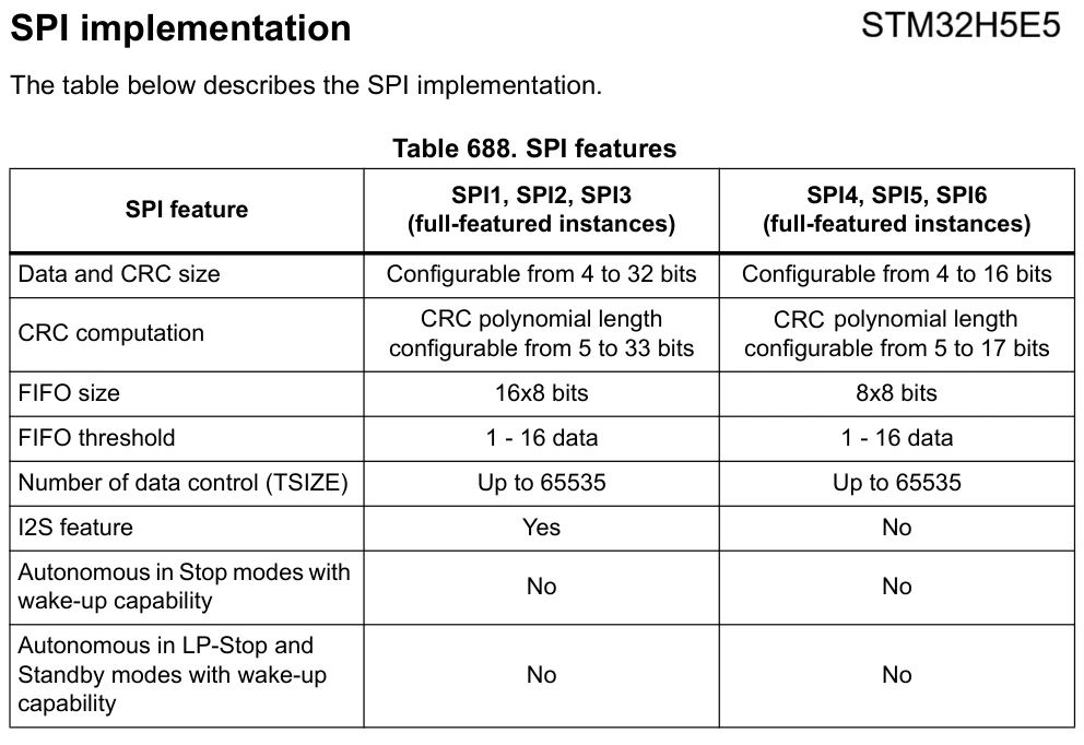

Having NSS does not save you from bit slip or data corruption probability in a given number of bits is same.  If you arrange CRC32 check over a reasonable size block you don’t loose much, often people assert NSS at start of that very same block holding it low until block ends what’s wrong with that?
So a CRC32 over that same block is an identical check - no difference.
Pulling NSS low for every word transferred is fixation - not adding anything.
And the CRC32 is done in hardware at no cost. I’m working with STM32H5E5 CRC can be over any allowed TSIZE block length.
Bill's Notes
