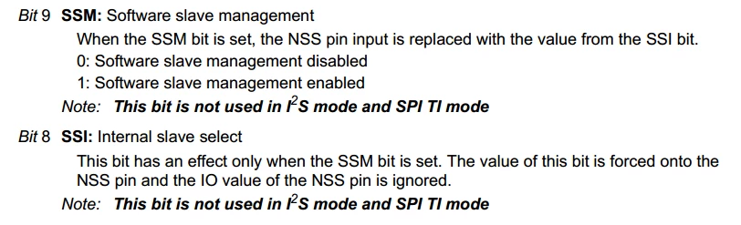

Hi guys!
I'm configuring the Nucleo 64 with the STM32F446RE to use SPI as a Master.
The problem I'm having right now is that the NSS pin is always low. Clock and MOSI are perfect. What I would like is that the NSS is high, and goes low during the transmission, then high again.
I've tried setting the NSS as Hardware output, and Software in Cube, but still failed to get what I want.
I think this configuration should be sorted with the following 3 bits, from CR1 and CR2. Right now Cube is setting SSOE= 1, SSM=1, SSI=1. And the NSS pin is configured as hardware output in Cube.
Any clues on how should I setup this? I would like to avoid having to use a random pin as CS and pull it manually.
Thanks!!
    There's no such functionality in the F4 SPI. In some other STM32 families, NSS may be active only during transmission, but then also toggles between frames (bytes), which may not be what you want either.
    You have to do this 'manually', setting the NSS pin as GPIO output. Don't forget the NSS input signal into the SPI module needs to be low (internally) low even if set to soft-NSS.

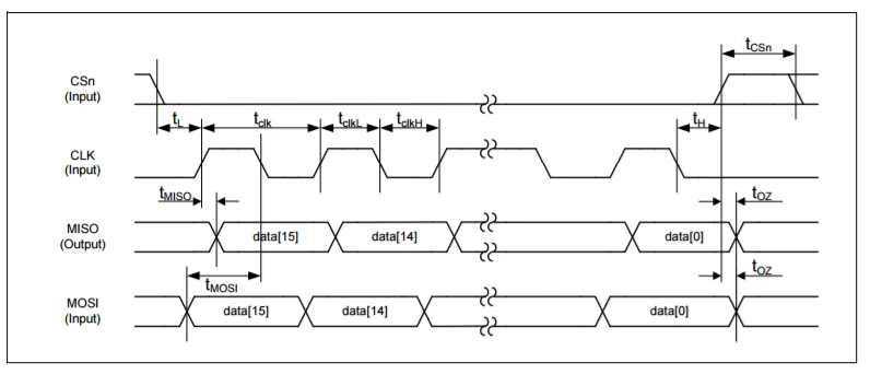

    Andres Cao
    March 3, 2017
    Posted on March 03, 2017 at 14:00
    Thanks for your help!
    So if I want to implement a simple 16bit spi protocol, as shown (AS5048 encoder), I have to do it manually?
    This would negate all advantages of using DMA since I still have to poll the busy flag to set it high again.
    What still puzzles me is that the NSS signal goes low immediately after the MX_SPI2_Init() function.

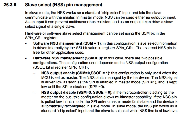

    March 3, 2017
    Posted on March 03, 2017 at 14:03

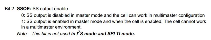

    You may assign NSS as GPIO CS, as the reference manual RM0390 says for Hardware NSS management (SSM = 0) that:
    NSS output enable (SSM=0,SSOE = 1): this configuration is only used when the MCU is set as master. The NSS pin is managed by the hardware. The NSS signal is driven low as soon as the SPI is enabled in master mode (SPE=1), and is kept low until the SPI is disabled (SPE =0).

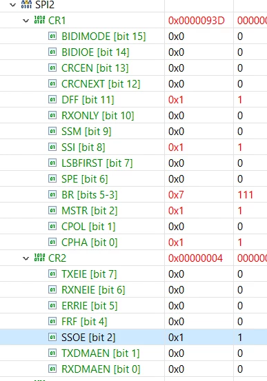

    Andres Cao
    March 3, 2017

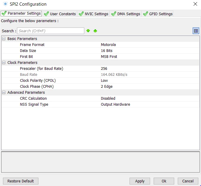

    Posted on March 03, 2017 at 14:13
    Hi Imen, thanks for your answer.
    To my understanding, that's what I'm doing in Cube :
    And checking the CR1&2 register values after init, it all seems ok, as shown. However, the NSS pin is driven low and stays there.
    Any clues?
    Nemui Trinomius
    March 3, 2017
    Posted on March 03, 2017 at 15:06
    Dear Andres Cao,
    Change SSM bit to 1.
    On CubeMX, Change NSS signal type to Software output.
    Best regards,
    Nemui.

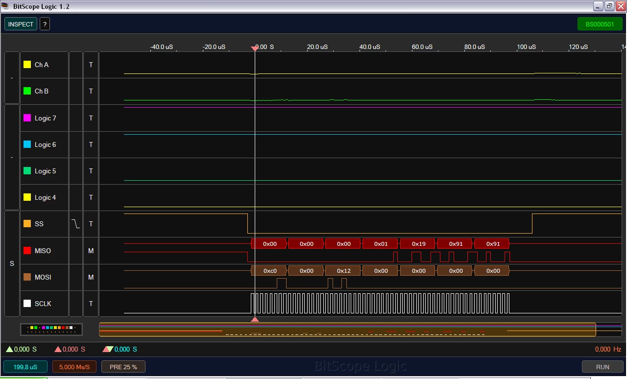

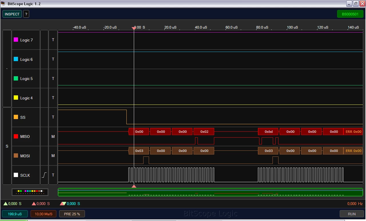

    I had to face the same problem, but on the STM32F105, SPI master + DMA and hardware NSS.
    Before I had found the issue it looked like this
    After reading the discussion I realized that disabling the SPI in DMA callback resolves the issue.
    static void SpiCallback(SPI_HandleTypeDef *hspi)
       __HAL_SPI_DISABLE(hspi); // disable NSS
    void HAL_SPI_ErrorCallback(SPI_HandleTypeDef *hspi)
       { SpiCallback(hspi); };
    void HAL_SPI_TxRxCpltCallback(SPI_HandleTypeDef *hspi)
    void HAL_SPI_TxCpltCallback(SPI_HandleTypeDef *hspi)
    After that transmission looks like this.
    I hope it will help you.

    It is not writen in any RM or DS  that NSS pin in Master mode,  is responsible to control the CS of a slave device and to provide the necessary timing for this!
    It is very clear also, in Master mode, that  NSS pin is kept low when master enabled  until the master is disabled.
    So this is not a problem.  is the normal behaviour of SPI Master NSS pin.
    When a Master  keep the NSS pin low in a multi device bus , this means  that all devices (with same NSS functionality) will be forced to act as slaves and will not try to act as Masters.(if properly configured for this ofcourse).
    When  the Master  frees the NSS line, informs the bus that any other device can take the control of the bus as a new Master by forcing his  NSS pin low.
    Conclusion. If you want to have one Master on the bus , and only slave devices , inside Master's device the NSS functionality is useless and the GPIO can be used as an ordinary pin.
