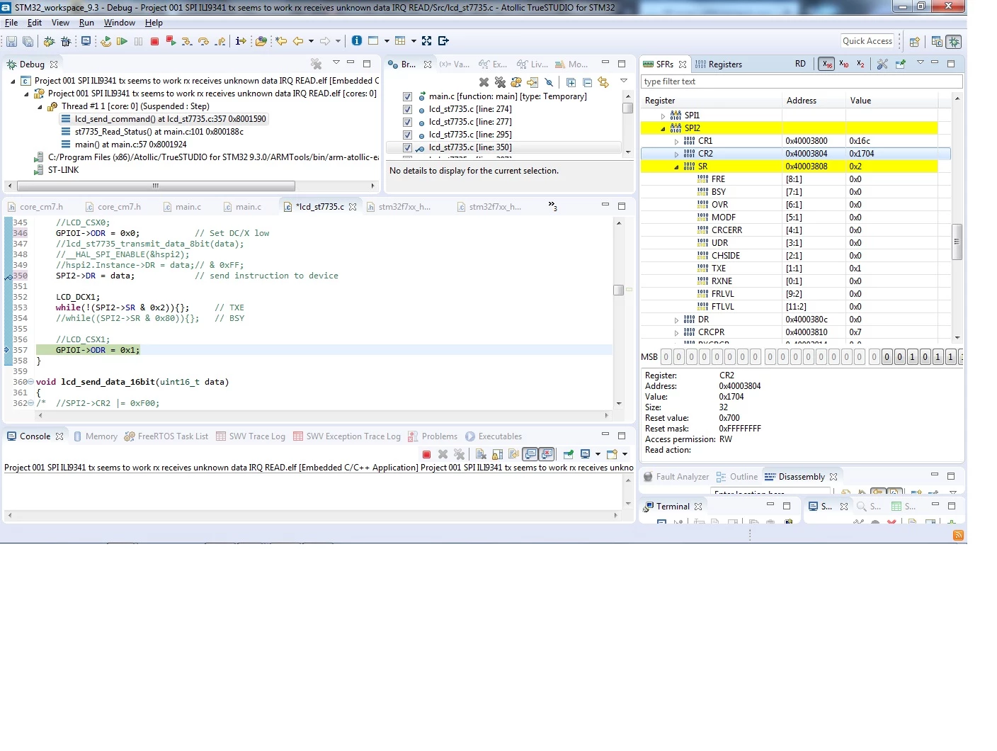

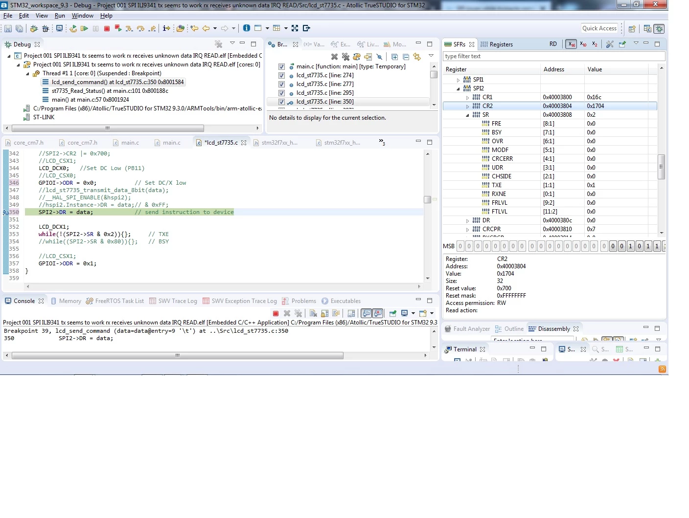

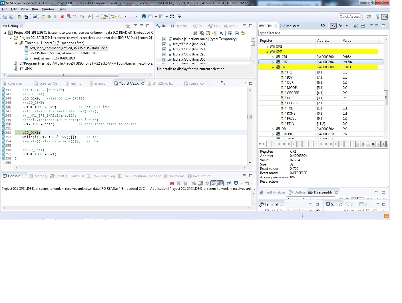

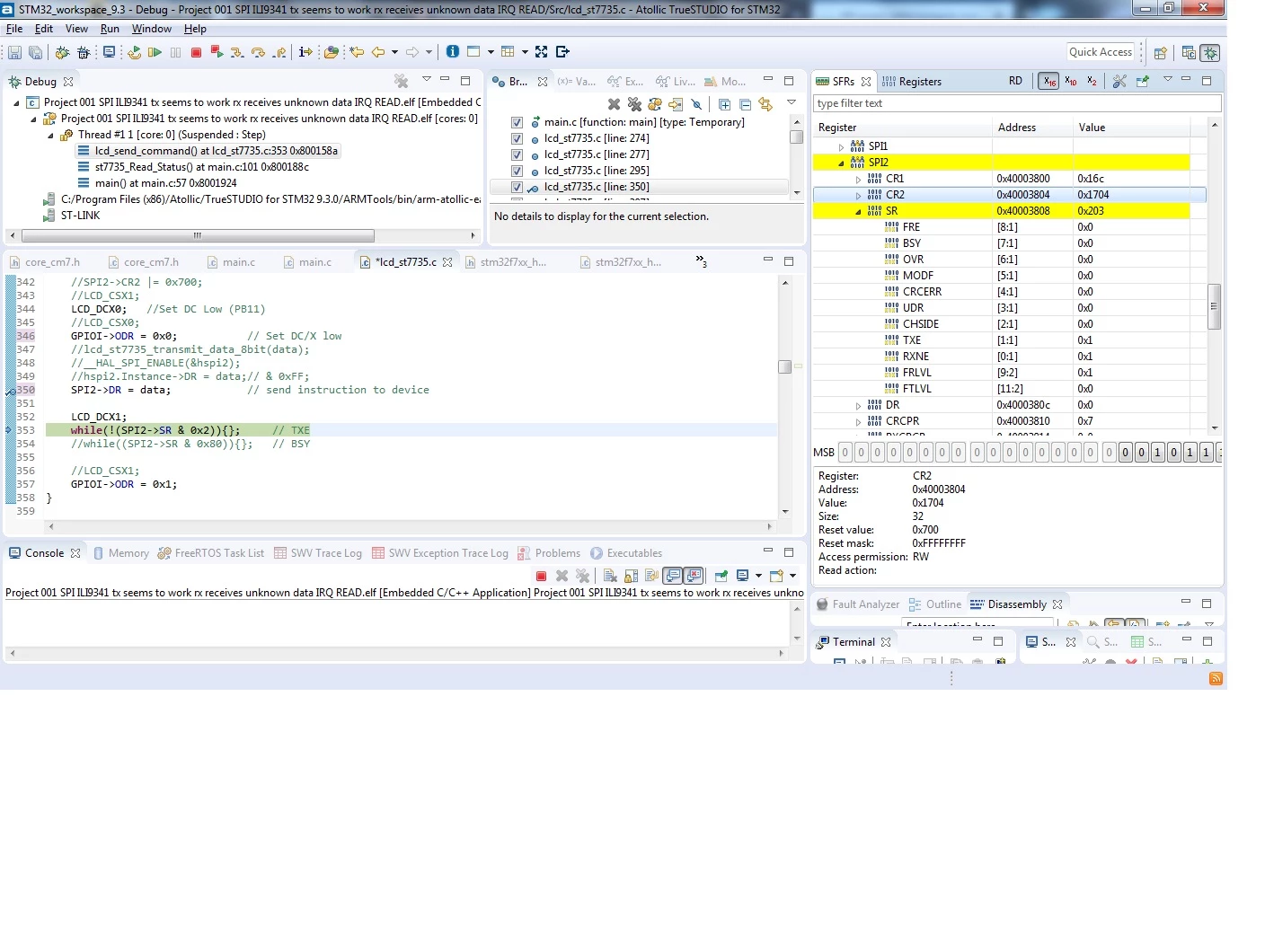

Well, here's what I've got:
This is my SPI init:
void MX_SPI2_Init(void)
 hspi2.Instance = SPI2;
 hspi2.Init.Mode = SPI_MODE_MASTER;
 hspi2.Init.Direction = SPI_DIRECTION_2LINES;
 hspi2.Init.DataSize = SPI_DATASIZE_8BIT;
 hspi2.Init.CLKPolarity = SPI_POLARITY_LOW;
 hspi2.Init.CLKPhase = SPI_PHASE_1EDGE;
 hspi2.Init.NSS = SPI_NSS_HARD_OUTPUT;
 //hspi2.Init.BaudRatePrescaler = SPI_BAUDRATEPRESCALER_2;		// resulting in 11 mHz
 //hspi2.Init.BaudRatePrescaler = SPI_BAUDRATEPRESCALER_4;
 hspi2.Init.BaudRatePrescaler = SPI_BAUDRATEPRESCALER_64;
 hspi2.Init.FirstBit = SPI_FIRSTBIT_MSB;
 hspi2.Init.TIMode = SPI_TIMODE_DISABLE;
 hspi2.Init.CRCCalculation = SPI_CRCCALCULATION_DISABLE;
 hspi2.Init.CRCPolynomial = 10;
 hspi2.Init.NSSPMode = SPI_NSS_PULSE_DISABLE;
 if (HAL_SPI_Init(&hspi2) != HAL_OK)
 Error_Handler();
And this is what shows in the debugger
0693W000000UXRoQAO.jpg0693W000000UXRyQAO.jpg0693W000000UXS3QAO.jpg0693W000000UXS8QAO.jpg
March 23, 2020
See the SFRs on the right? See the value for the DR register in there? Your debugger is reading the DR register, which is going to change how it works. There may be other issues as well.
