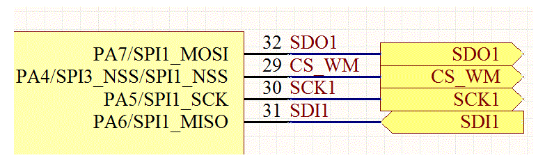

Hi everyone,

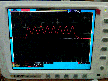

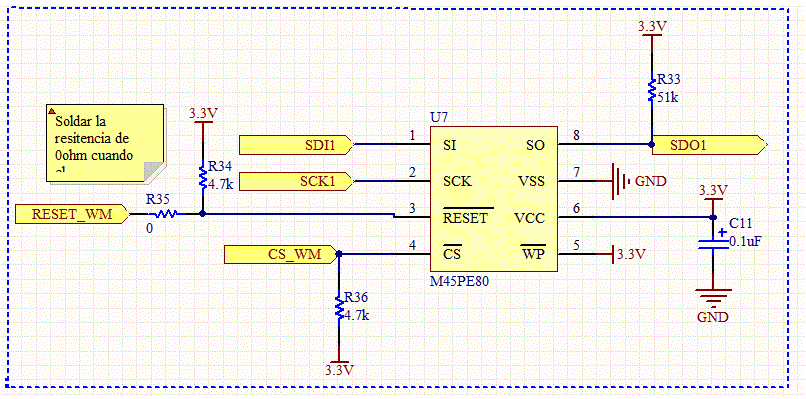

I am trying to implement the SPI1 by hardware in my STM32F407VGT6, I did everything and actually it seems to work. But I was trying to read the ID from my SPI device (which is a Flash Memory) and it doesn't work. So I used my
oscilloscope
to watch the signal clock , and I got a CLK signal with a level on the bottom of it. Take a look, this picture shows my clk signal on my oscilloscope:
As you can see the Signal has a level at the moment to start the clock signal. So, What do you think is happening with this?, and what are the hardware considerations to implement the SPI?, Should I use External Resistors?
