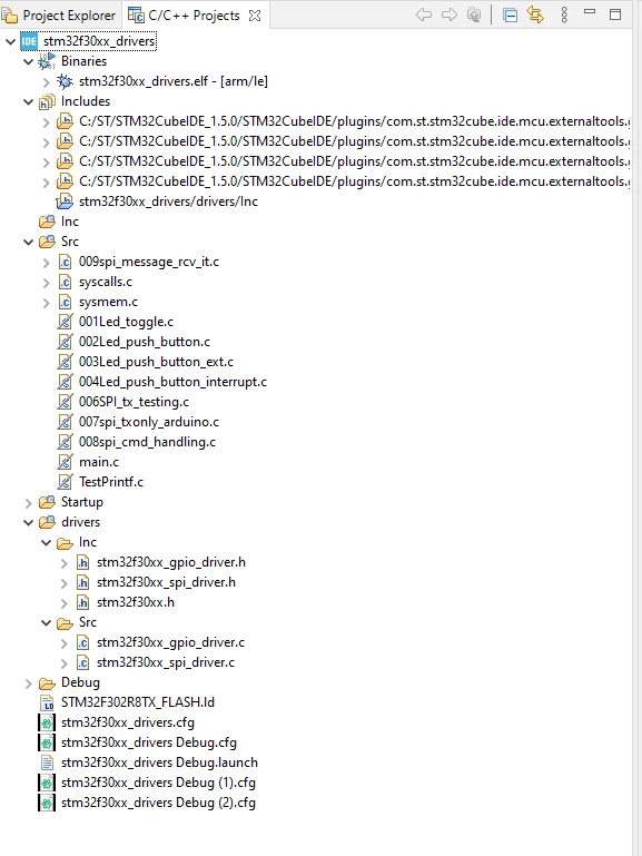

WM_IR
WM_IRAuthor
Jul 6, 2021 2:53 AM UTC
Sorry I keep asking, because Im eager to find the answers, Thank you for your responds I really appreciate it.
Regarding Im redefining the existing definitions in the CMSIS files. Where do find the files? I try to find an the left Tab but, I could not see it where it is located.
Jul 6, 2021 2:56 AM UTC
If you generate code using CubeMX, it will add them for you.
Otherwise, they can be found here:
https://github.com/STMicroelectronics/STM32CubeF3/tree/master/Drivers/CMSIS/Device/ST/STM32F3xx/Include
