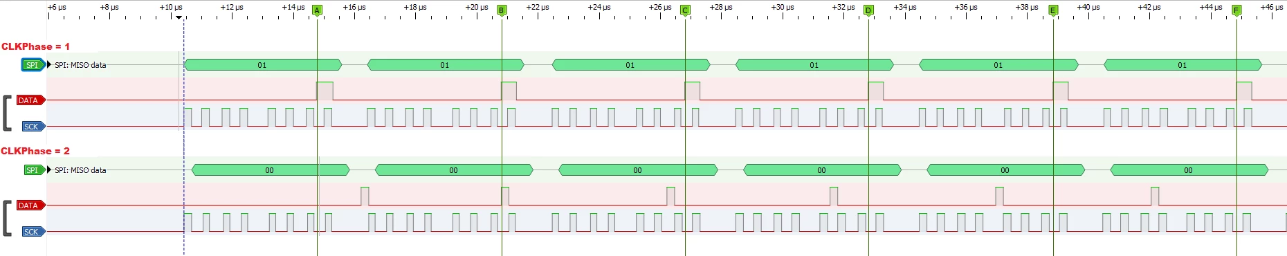

SPI half duplex slave transmit, data shifted / loses sync when using CLK Phase 2

Init code (Only CLKPhase changes between tests, 1=Leading edge, 2 =Trailing edge):

After starting HAL_SPI_Transmit, I send train of pulses.
The slave sends only 1s for easier detection.
CLKPhase = 1: Works ok. Also works with both clock polarities.
CLKPhase = 2: The data shifts and loses sync. Happens with both clock polarities.
I thought I was being too fast.
So I tried adding 1mS delay between clocks (Byte - delay - Byte - delay ...) but the result was the same.

I updated the message, It's not sending random garbage, it's the data that shifts and loses sync.

Yeah, I read them out a lot of times, both were exact the same at any given moment, only CR1 bit 0 ( CPHA, Clock phase) changed.
I think it might be a noise problem.
The SPI signal is not crazy high (1.7MHz), and the logic anaylizer sees everything ok, but I shortened a bit the wires and started working in both modes.
Or it might be a lucky shot, I'm still testing, will update later.
Oh. Wires? Tell us more. Post photo.
It's not the SPI clock rate, but the edges slew rate, which are important. Use terminators (series resistors in the order of few tens of ohms), and if you can change the slew rate, decrease it (e.g. if master is STM32, use a slower GPIO_OSPEEDR rate).
If you use wires/cable, make sure they are as short as possible, 10cm is a reasonable length, anything beyond that needs more care. Make sure every signal has its own return (ground), if you use flat cable, make sure each other wire is ground; otherwise twist the signal with its own return.

WQell, the culprit was the logic analyzer! Wires were not loo long, about 10cm.
But also they were plugged into a breadboard, that's asking for trouble at high frequencies.
The SPI worked well until I plugged the analyzer wires.
My problem was always at answering, (transmitting back).
Since I removed the analyzer everything is working.
I guess capacitance was too high or it caused ringing / signal reflection.
I don't have DSO right now, so I couldn't check the signal integrity.
Huh, try to see those things with the analogic one! :face_with_tears_of_joy:
The strange thing is that it always worked with clock phase 1.
That totally misleaded me!
