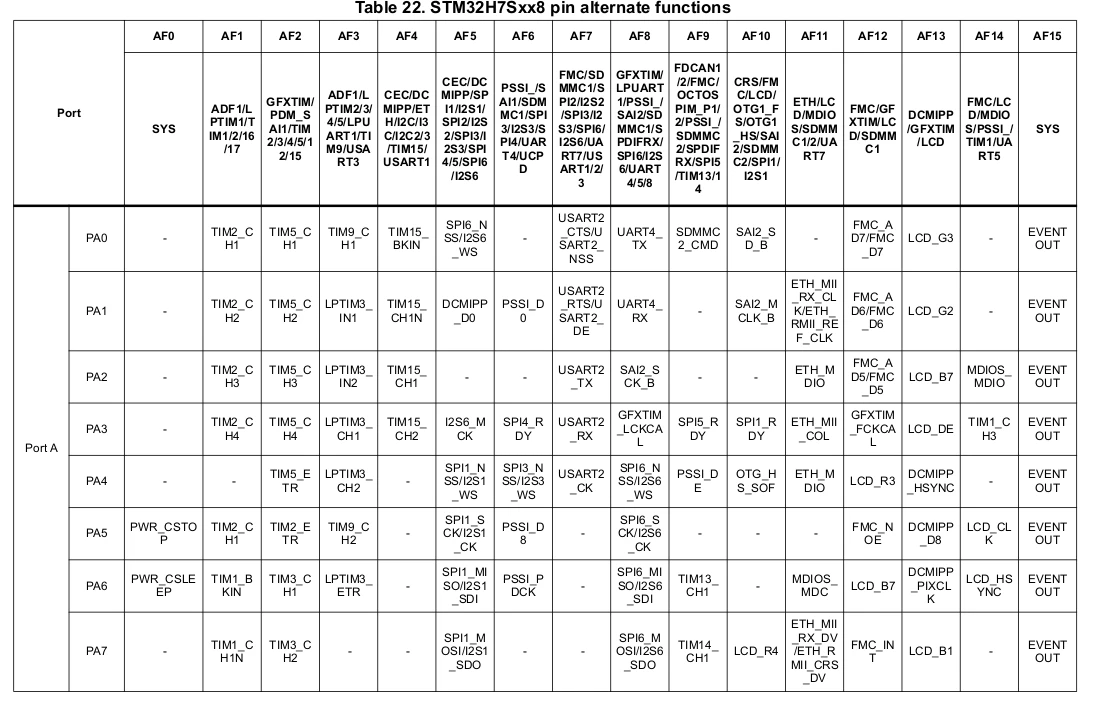

Despite having configured it for SPI6 Alternate Function (according to datasheet)
 // SPI6 pins
 // SCLK, MISO, MISO, NSS
 GPIO_InitStruct.Pin = LL_GPIO_PIN_4 | LL_GPIO_PIN_5 | LL_GPIO_PIN_6 | LL_GPIO_PIN_7;
 GPIO_InitStruct.Mode = LL_GPIO_MODE_ALTERNATE;
 GPIO_InitStruct.Speed = LL_GPIO_SPEED_FREQ_VERY_HIGH;
 GPIO_InitStruct.OutputType = LL_GPIO_OUTPUT_PUSHPULL;
 GPIO_InitStruct.Pull = LL_GPIO_PULL_UP;
 GPIO_InitStruct.Alternate = LL_GPIO_AF_8;
 LL_GPIO_Init(GPIOA, &GPIO_InitStruct);
it always stays to low level.

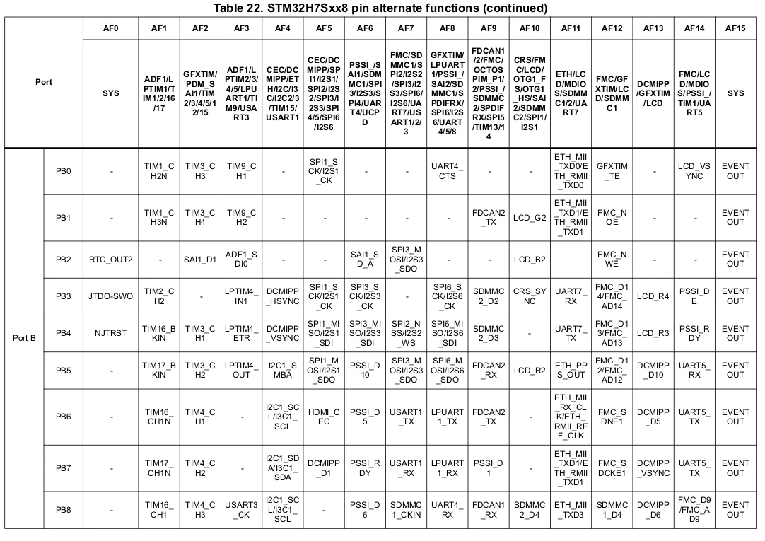

What is strange is the fact that if I use PB5 as SPI6 MOSI
I can see as the pin stays at high level in idle state, but low for the rest of transmission, and this is quiet confusing.
If I am not blind at all, the TRM and datasheet does not say anything about it..

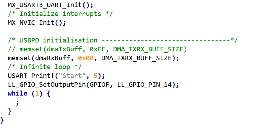

The SPI DMA transfer is triggered from EXTI13_IRQHandler() in stm32h7rsxx_it.c.
As a push button handling is quiet horrible without a timer de-bounce delay but does the job for testing purpose only.
