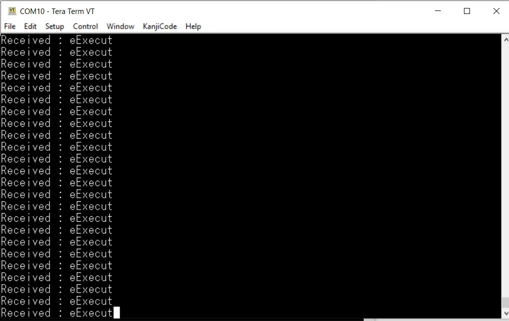

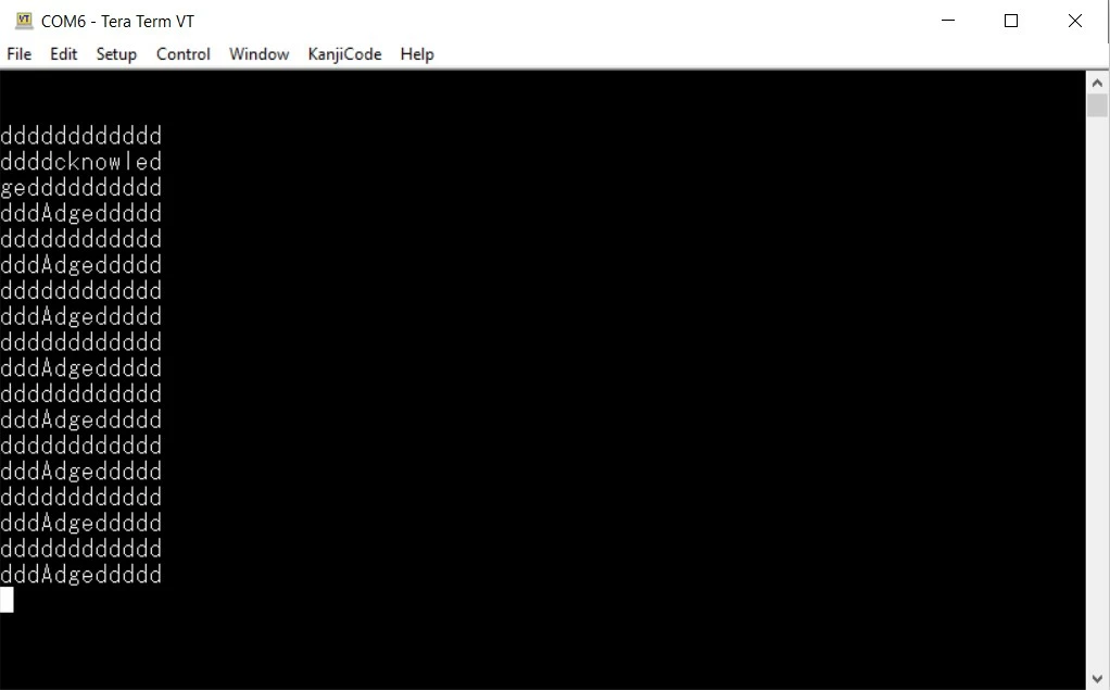

If I run the code on either side of "**************" line individually it works correctly, I get the correct string on PC terminal.
But with the code shown above, this is what I get
On master side:
On slave side:
The slave side seems to be receiving it somewhat correctly, while the master is receiving absolutely wrong message.
What I am doing wrong?

The master side
  • transmits some bytes
  • waits 1 ms
  • receives some bytes
The slave side
  • transmits them to a UART
  • waits 1 ms
Calling uart_txstr() in the slave loop guarantees that the slave is always late to the party, and can't respond in time.
> Assume all functions called work correctly.
Define correctly.
How long does delayms(1) wait? Hint: if it is dependent in some way on a counter variable which is incremented by a timer interrupt, then it is not exactly 1 ms, but either between 0 ms and 1 ms, or between 1 ms or 2 ms.
What does SPI_write() do? Does "work correctly" imply that it is not only putting a byte into the transmit register when it becomes empty, or there is a free slot in the transmit fifo, or does it actually wait for a byte to appear in the receive data register? What does it check after writing the data register?
What does SPI_read() do? Does "work correctly" imply that it is checking the transition of CS, and flushing the input buffer when necessary?

You aren't operating in true full duplex SPI mode. Data is transferred in both directions at the same time, based on clock edge. The master SPI supplies the clock and begins the transmission. At each edge a bit is clocked from the master TX register into the slave RX register, while the slave TX buffer is clocked into the master RX buffer. This works best with DMA to handle actual data transfers, assuming it's fixed length. Don't think of SPI as a fast UART; it operates in a synchronous mode where both sides set up the data exchange in advance.
This method takes less than half the time to communicate between the two boards compared to your algorithm, and far less CPU time if you use DMA.
