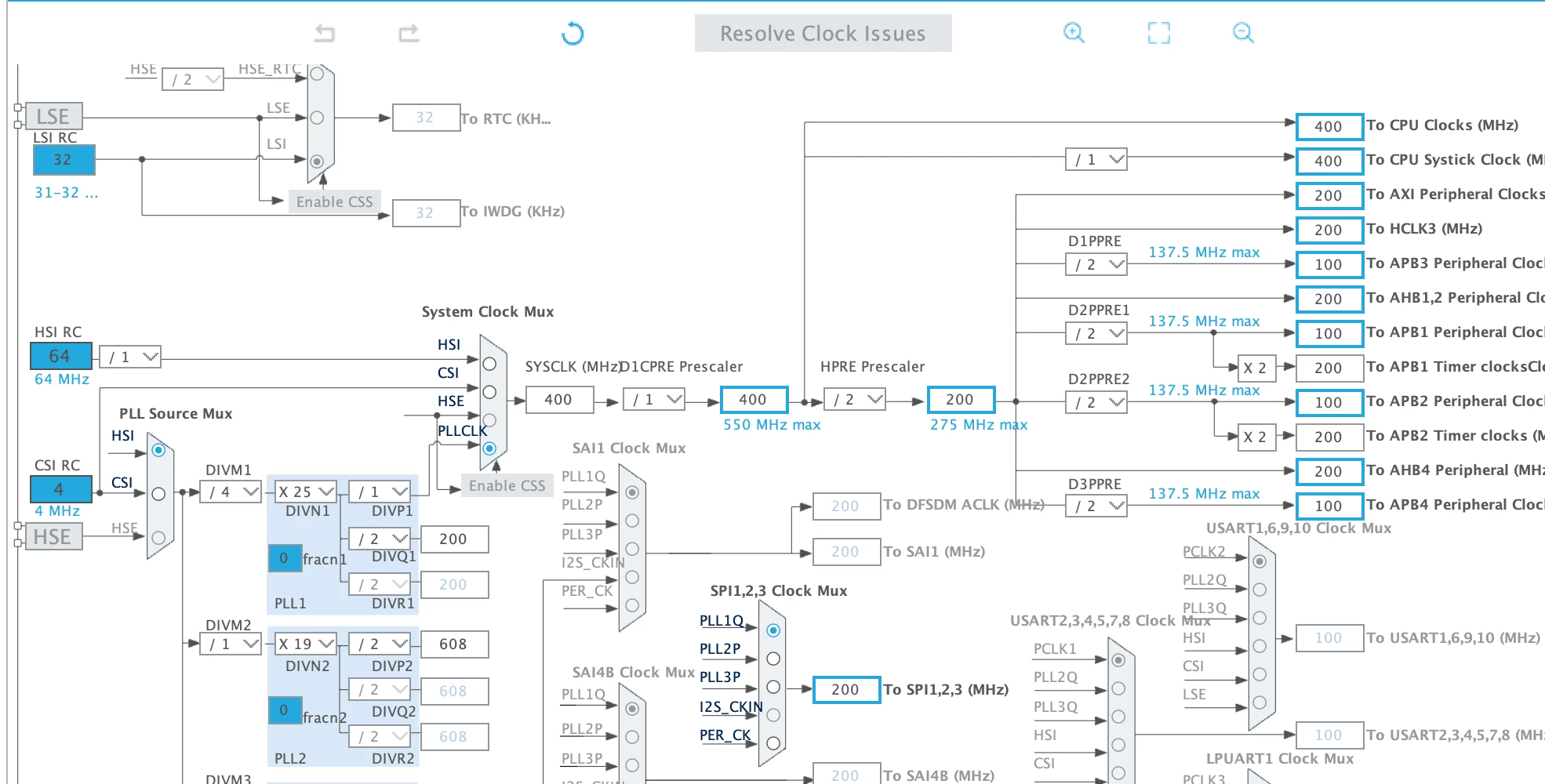

Hello guys,
I'm testing a PDM mic with the nucleo-h723gz to capture in polling mode. Now I tested it with the I2S peripheral and I don't have any problem at all. But when i try to use the SPI I don't get any data: my buffer remain empty and the register happen to be cleared (after the initialisation). Every time my project get stuck in the timeout management in the ***_hal_spi.c (the RXWNE/FRLVL flags are always zero). I thought the problem can be that the PDM fail to deliver any data cause it isn't clocked properly, but I tried already various combination for the clock.
My PDM mic works when it has a clock 1-3 MHz. So the only thing necessary is a baud rate 1-3 Mbits/s, isn't?
Or I have to set the peripheral clock to a right value?
This is my clock configuration.
PS. also I attached the main.c

I forgot to say that I adjusted the baud rate prescaler at 128, in order to have a baud rate of 1,56Mbits/s.
